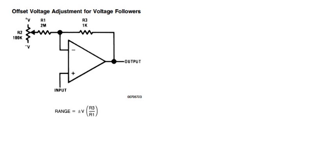

    It works normally, It does not overheat, however, I have a problem that I would like to fix.
    I have a high offset voltage at the output 660mV when I connect my input (pin 4 = IN+) to ground
    Could I reduce the offset voltage in my OpAmp?
    I tried putting -5V in my input (pin 4) and my output was 10mV, It was really good, but Is there another way to reduce that offset voltage?
    Is it normal that I get high offset voltage in a voltage follower configuration?
    I wa thinking in the next diagram.
    Thanks a lot

  • Hi Pedro,
    Using the OPA549 with a 12V single supply the minimum input common mode voltage is -.2V. Therefore applying a -5V input is outside the linear operation of the amplifier.
    The typical output swing is 0.1V from the negative rail with an 8 ohm load connected to the negative supply. Therefore when you connect IN+ to ground, the output of the amplifier attempts to go to 0V. However, the output can only swing to 0.1V. Therefore the output swing limitation of the amplifier is being violated and the amplifier is outside of the linear operating region when the IN+ pin is grounded.
    I recommend watching our TI Precision Lab videos on input and output limitations to fully understand why the amplifier is outside of the linear operating region.
    Using the configuration you show will still violate the input common mode with a -5V input.
