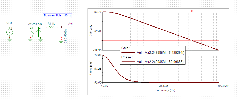

    I think you'll find the answers to many of your questions in the TI Precision Labs Videos on bandwidth, slew-rate, and stability.  The bandwidth videos provide an in-depth explanation on op amp open-loop gain (Aol) including how to calculate the dominant pole from the DC Aol value and the UGBW.
    For the TLC2272 the DC Aol is between 35V/mV (90.88dB) and 50V/mV (93.98dB).  The GBWP is 2.25MHz for the 50V/mV DC Aol so the dominant pole can be calculated as shown below:
    Dominant Pole = UGBW / Aol = 2.25MHz / 50000 = 45Hz.
    Aol.TSC

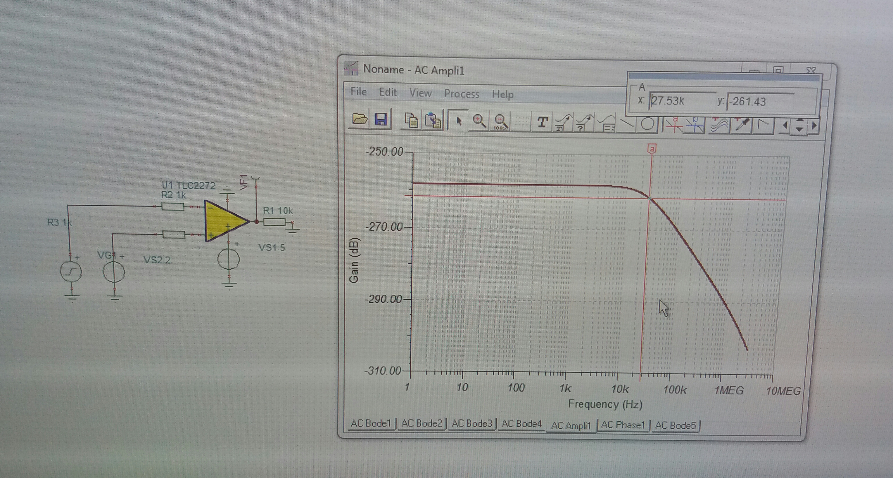

    Bu Tina Ti return the atached result hopefully it' visible). Could you please explain the discrepancy?

  • So, the Tina result for an open loop configuration:
    Therefore, most probably, the Tina design or model is not applicable for this purpose; but I'd be interested to find out the answer. Thank you!
    This is not a valid circuit to test the open-loop gain of an op amp.  Without feedback the output will saturate into one rail or the other which will collapse the open-loop gain.  Please go through the TI Precision Labs videos on op amp bandwidth and stability to understand more about op amp open-loop gain and how to simulate it.
