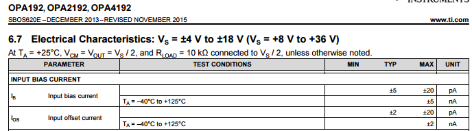

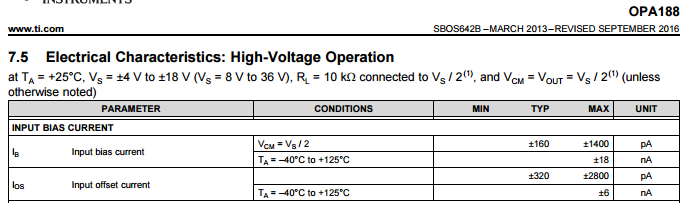

The OPA188 have a maximum input offset current of 6 nA
the OPA192 have maximum input offset current of 2 nA

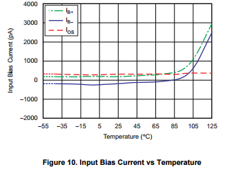

    All IB data you request for OPA188 and OPA192 is in the datasheet.  The maximum input offset current is +/-2800pA at 25C and it is maximum of +/-6nA at 125C.  We also show a typical graph of IB vs temperature in Fig 10 - see below.
    OPA188 IB vs Temp

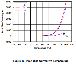

    Likewise, the maximum OPA192 Ios is 20pA at 25C and it increases to max of 2nA at 125C; also, please see Fig 19 below showing the typical graph of IB vs Temp.
    Notice that Ios in OPA188 is twice as great as either IB because in chopper amplifiers the input bias current goes into one input BUT comes out of the other input terminal.  This is not the case in all other type of op amp like OPA192 - Ios is always smaller than either of IB's.
