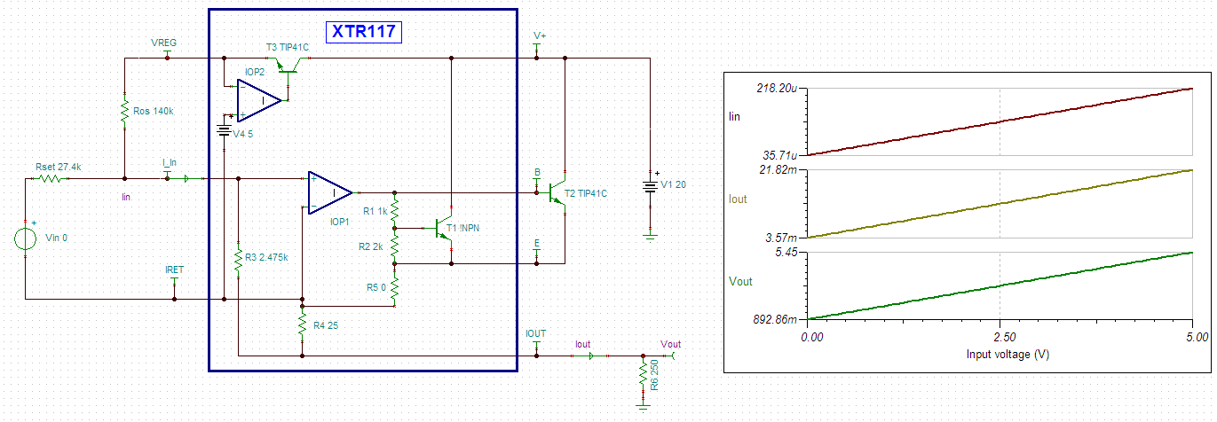

Dear Experts,
I am trying to interface Arduino PWM out in which 1-5 volts as required by XTR117 input is mapped into PWM and filtered out. Then it needs to be connected to XTR117 input. Can you please suggest a suitable circuit diagram and input filter component values and XTR117 input resistor. I am very new to current loops and need to design a demo tryout version. Sincere thanks.
