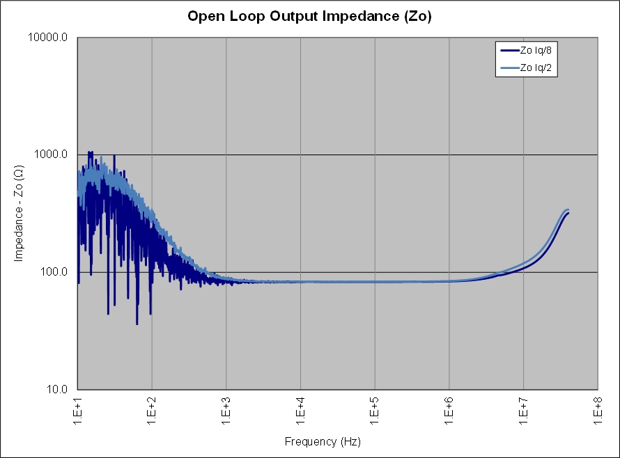

    Actually, after comparing the OPA340 datasheet curves with some measurements we made earlier this year, I'm not sure if the closed-loop output impedance is correct in the datasheet.  Here's a measurement of the open-loop output impedance of the OPA340 with both Iq/8 and Iq/2 loading.  Use these curves for your small-signal model.

    3.)  That is measured data based on driving a small current into the output of the op amp and measuring the resulting voltage (R = V/I)
    4.)  We weren't recording the phase on some of the older measurements so unfortunately I don' t have it.  That said, you'll have a pretty accurate model by just using the resistive portion of the output impedance which is roughly 85 Ohms over most of the usable bandwidth of the product.  The low frequency resistance and capacitive regions are less important because it's unlikely that the load impedance will interact with the curve at such low frequencies.  The curve does turn a little inductive after the unity-gain bandwidth which will affect some of the stability results with capacitive loads that intersect with the curve in that region.  Based on the data I took a look at a single-point measurement at 20.182MHz where the value of the impedance was 175.1 Ohms.  The inductance can be estimated therefore as:  L = X / (2*pi*f) = 175.1 / (2*pi*20,182,000) = 1.38uH.
