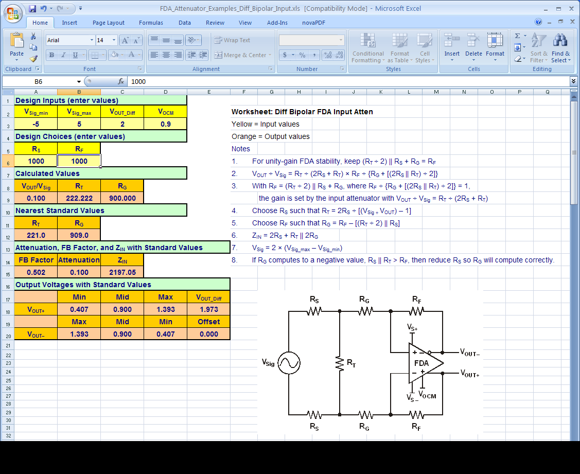

I chose the value for the different resistors (reference designators can be seen in the attached screenshot of the excel file; this excel file came with slyt336 application note from TI).

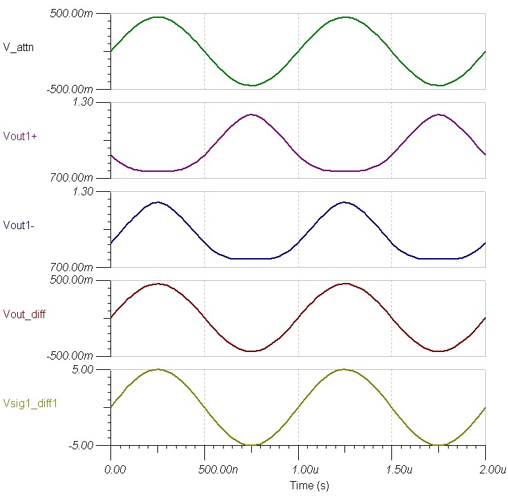

There are three questions:
1) I don't see the swing range as shown by the excel file
2) Vout+ & Vout- are distorted but their difference "seems" correct. Is this supposed to happen and is it correct to implement?

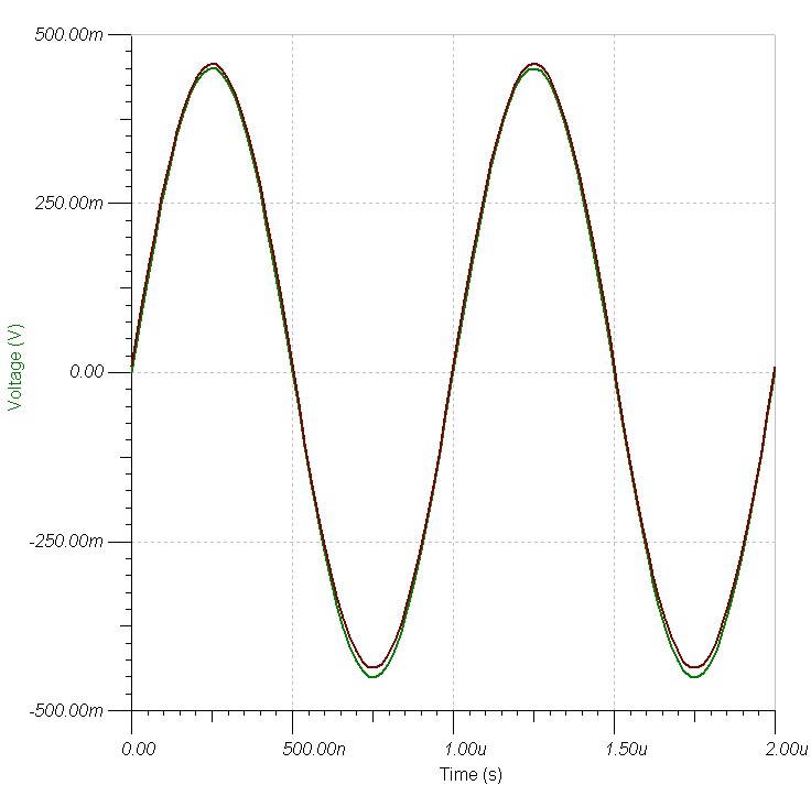

3) Vout_diff voltmeter is inverted in-order to see if the input and output waveforms are similar. It can be seen that there is a small dc-offset introduced in the output.

    The LMH6551Q-Q1 cannot be used with a single 5V supply as you've connected it and be able to support your needs:
    VoCM= 0.9V
    Vout= 2Vpp diff.

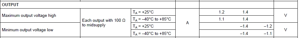

    Each output would have to swing 1Vpp with Vocm set to 0.9V meaning minimum output swing is only 0.4V from ground. The datasheet shows that with 5V single supply (Vs= +/-2.5V), output swing is typically 1.1V from either supply rail (headroom = 2.5V - 2.8Vpp/2 = 1.1V):
    So, you would need to tie the V- pin of the FDA to a potential at least 1.1V below the expected minimum output swing (0.4V with respect to ground). So, either V- of -2.5V or -5V would work.

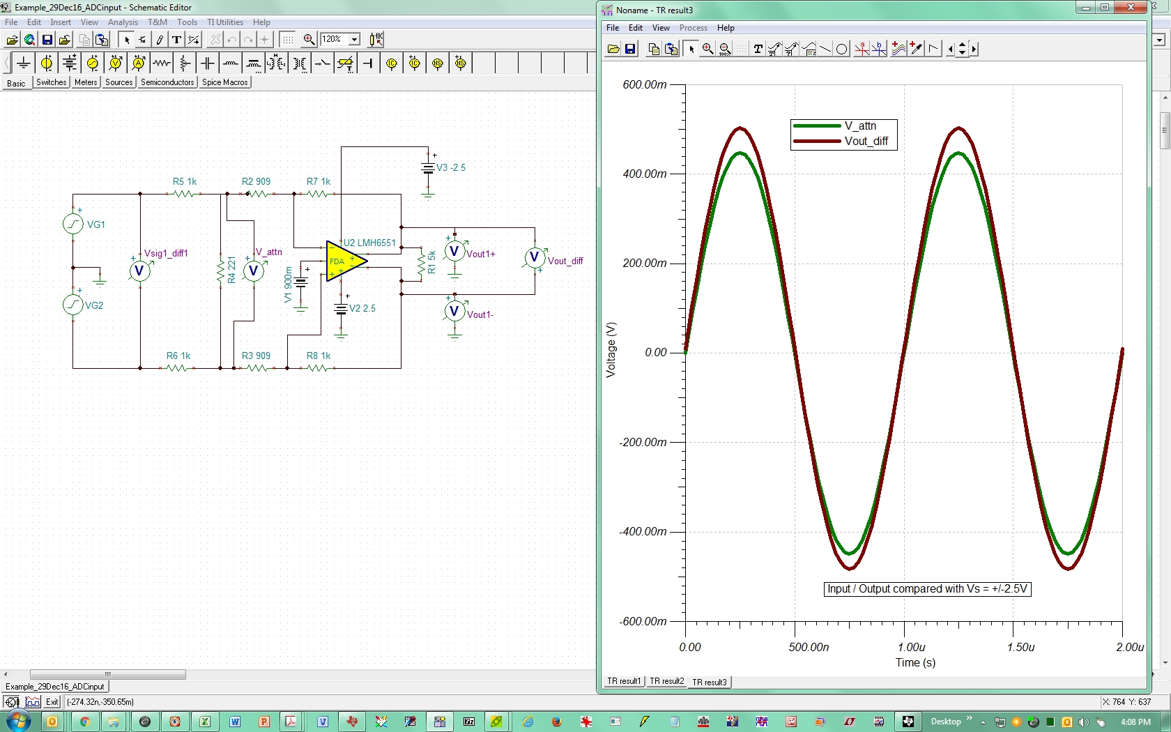

    Here is the response with Vs= +/-2.V where the swing looks "symmetrical" (but at a gain of >1):
    Here is the modified TINA-TI file for reference:
    I couldn't have figured this out on my own!
    Following is the excel file that I got from TI
    FDA_Attenuator_Examples_Diff_Bipolar_Input.xls
    Some more questions:
    0) Is 0.9V in the acceptable output common mode range of the opamp? As per a line in the same table of the datasheet, [min, max]|VoCM = [1.2, 3.8].
    1) As per the excel file, for the chosen resistor values the output swing should be 2V p2p, however we are seeing something closer to 1V p2p. May I ask you to please help me understand the difference.

    Question 1) As per the excel file, for the chosen resistor values the output swing should be 2V p2p, however we are seeing something closer to 1V p2p. May I ask you to please help me understand the difference.
    Response: I think that spreadsheet is based on computation only and does not take into account the device limitations.

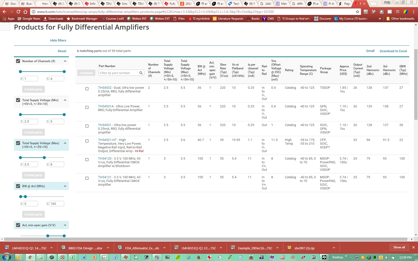

    Question 3) Introducing a negative voltage rail is always an issue, may I ask you to please suggest an alternate low cost FDA. The input signal BW is only 3MHz (max).
    Response: You can take a look at RR output FDA's here which I've already filtered for your needs:

  • Sorry!
    Looks like the FDA selection tool link I sent you for Response 3 above, does not include the filters I imposed. Here is the screen shot:
    Hooman
