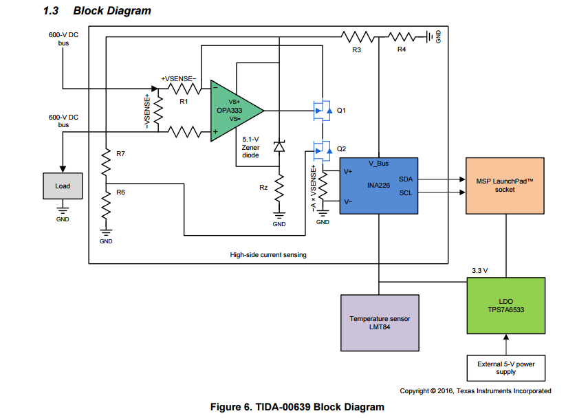

Below is TIDA-00639 600-V Unidirectional Current sensing design. But I have one question as block diagram. Does OPA333 support 600V common mode range? Why 600V DC bus input OPA333 input directly? Thank you.
BR
Patrick
