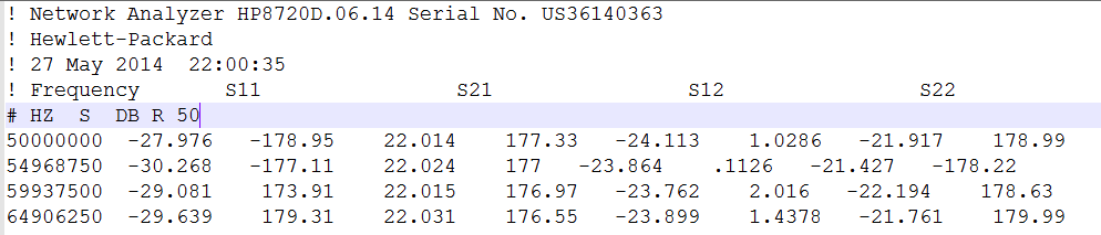

1- Can you provide full s-parameter data for 100nH, 680nH and 4.7uH assembled in the TRF37D73EVM covering 1Mhz-6GHz. The information available online is for very limited frequency range, not covering the full device range, only the lowest frequency range up to 400MHz max.

    1- Thanks for the pointer to this, we got the ones related to the EVM earlier and not the ones for the part itself, which are in a different place. Anyway, unfortunately S-Parameters file you point to does not get lower than 50MHz. The part is supposed to be characterized and suggested from frequencies of 1Mhz and up to 6GHz.

    1. I don't think the part has been characterized from frequencies of 1MHz up to 6GHz all at once, using only one circuit configuration. The main limitation in this is the availability of high value choke inductors with high SRF values. It is possible to operate the part close to 1MHz using high value choke inductors (4.7uH); but then due to lower SRF value of these inductors, the maximum operating frequency gets limited. The file you have shown above is characterized using 100nH choke inductor which limits the performance to 50MHz on the lower end and goes up to 6GHz. I think the dependence of TRF37D73 performance on choke inductors is explained in this article: http://www.tij.co.jp/jp/lit/ug/tidu607/tidu607.pdf
