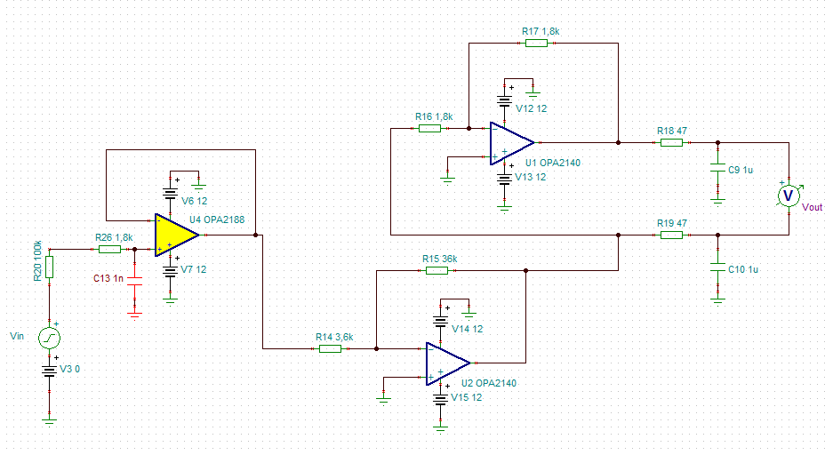

I am using the OPA2188 in an active filter (SKT) with digitally programmable cut frequency using a trimmer. The frequencies of interest are pretty low (10 Hz - 1 kHz), and I am forced to use quite high resistances (100k) in order to use NP0 capacitors.
I am experiencing unexpected high noise and I am suspecting that input current noise is ~100x higher than the 7 fA/Hz^0.5 quoted in the datasheet.
I built a small test circuit, measured it and also simulated it with TINA.
TINA seems to behave as expected from the datasheet values, while measurement shows 800 fA/Hz^0.5.
Do you have any ideas or suggestions?
