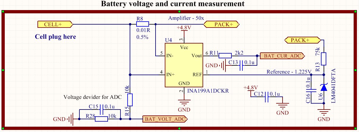

I have question about INA199A1DCKR and datasheet states that it's gain is 50V/V, but in my design I get 100V/V, maybe I do not understant something? My device trully is INA199A1, because I have checked device marking three times and it is written "OBG", that means it is 100% 199A1, not 199A2. I have attached my circuit . In both current flow directions INA199A1 amplifies 100 times, not 50 as stated in datasheet. I have 5 demo boards for prototyping and they all acts the same - can I trust that next devices 199A1 will have gain = 100, or it may be 50, 100, 200 depending on air conditions?

    thank You for the answer, but the problem, that I have measured everywhere where I could, before posting here. I am connecting just +4.8 and pack voltage - no current is flowing through R8 resistor, Vout is stable = 1.225V, the same as reference, then I connect this circuit in normal working state - current is flowing through R8 to one direction - voltge between 4 and 5 pin is 0.01V, I get ~2.225V on Vout pin. The same situation when current is flowing vice versa - I get ~10mV (different sign) between 4 and 5 pin and Vout~0.225V. Can You tell me where else I can probe? Reference stays stable all the time, multimeters internal resistance is >1MOhm, no other capacitive or resistive loads are added...

    Thanks for double checking for us. You are correct, with a 10mV Vshunt and 1.225V reference you should not be seeing 2.225V in Vout. At this point I would like to provide faster support by getting some of your parts here for me to test them on the lab.

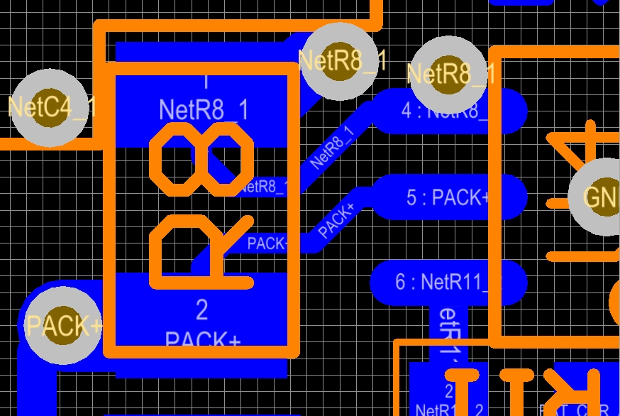

    I have attached layout. We are measuring really small currents, 1A, maybe a bit more, so I would guess it should not be really big problems in layout, because track resistance could not be comparable to shunt resistor... I understand if I would design current measurement for 100A, there would be difference to which resistor part to connect track, but now current density is really low and there is no any chances that there would be any voltage drop between shunt resistor different parts of pads (in my design, I take voltage from the center of pad)...
