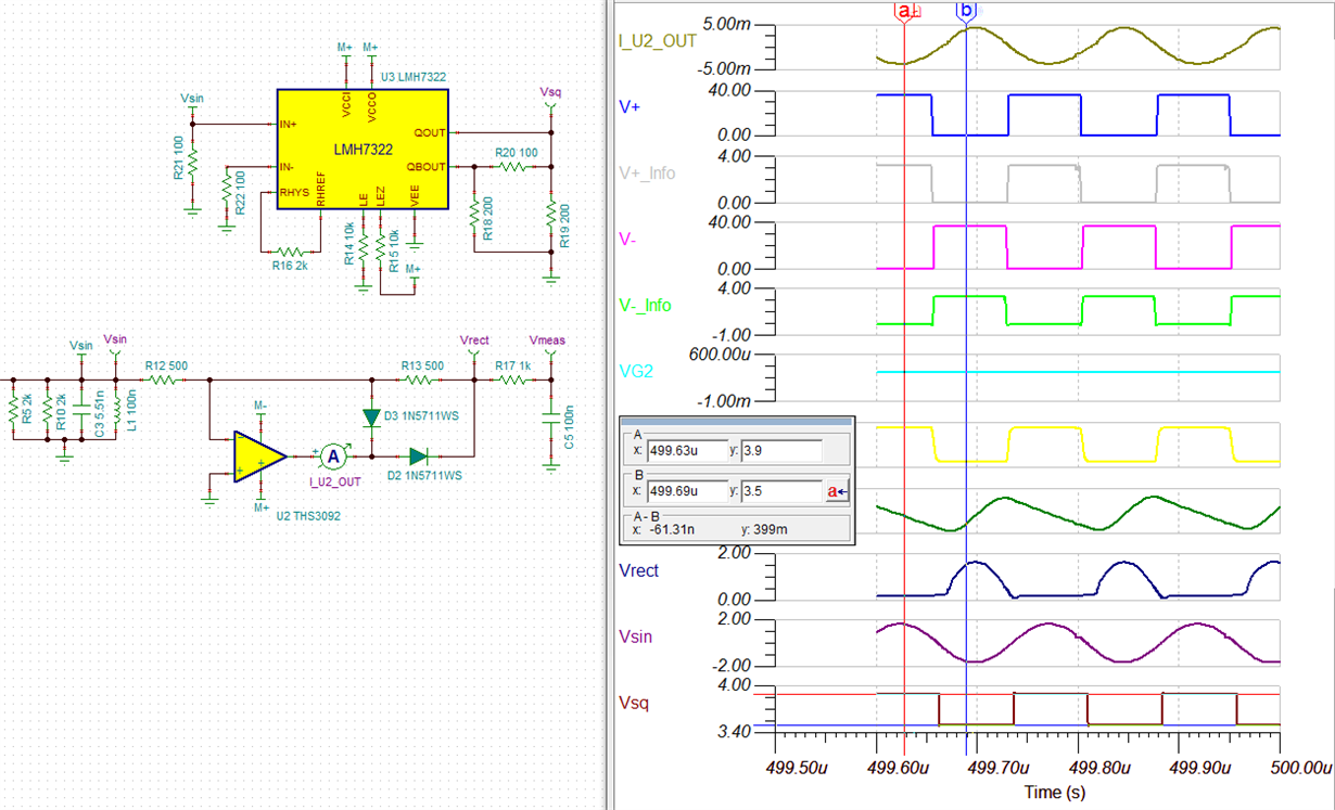

I have designed my board around LMH7322 with following schematic
But output of board is not changing. Now I suspect that latch is not enabled. Because LE and LEB connections are swapped in EVAL schematic.
Simulation also works if both LE and LEB are connected to ground but on board situation remains the same and we don't get the output.
Please confirm the issue if there is a problem with spice model supplied. Will it work if I swap the connection of LE and LEB.

  • 6560.Resonant Filter Board design.TSCCan I hijack this thread?? I am having trouble with the output of this part as well! I can't even get the simulation to work!
  • Hi Xavier,
    I have attached a slight modification to your LMH7322 circuit which should toggle the LMH7322 outputs based on your inputs. Attached TINA-TI circuit for the same:7853.6560.Resonant Filter Board design.TSC
    Let me know if this works.
    Rohit

  • Wait... I just realized on your simulation that the LMH7322 is only toggling between 3.9 and 3.5... why isn't it doing the full range of 5 to 0?? Is it not supposed to?
    5 minute later Edit: Dammit I just realized how the RSPECL outputs work. I can't use this part.
    10 minute later Edit: Small bit of frustration that it doesn't specify the RSPECL output levels explicitly EXCEPT for in diagrams which is very easy to overlook.
    12 minute later Edit: I found where it specifies it... VCCO-1.1V and VCCO-1.5V.
