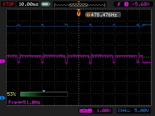

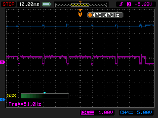

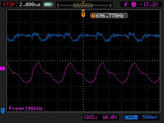

    • Now,I describe my circuit. In the circuit that the power of OPA548  is ±30 voltage , And when the load is 1Ohm  the OPA548 output  5 voltage .First,When the OPA548 output  positive 2 Amp(And the load is 1Ohm),the output waveform is like the picture 1. (Notice : my input signal is   DC signal all the time ) In the picture , the waveform should be straight line ,because of the input signal is DC .But the  wave is square wave.(I think that is very ***)    Second, when the OPA548 output negative 2 Amp ,the output waveform is  picture 2. the wave of the picture 2 is oscillation ?  I  add that when the OPA548 output  either positive 2 Amp or negative 2  Amp ,the first  3  seconds is fine sometimes .There are two ideals that the first is stability and the second is overheating protection. For stability , I add the RC snubber  at the  exit of OPA548 ,but the way is useless. But  I think  overheating protection is more possibility . So far my problem is still unresolved.Can you help me??   What happened ?
                               picture 1
        picture  2
