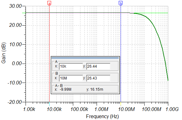

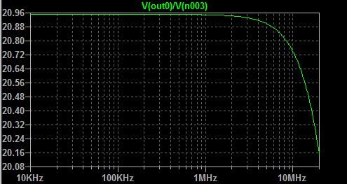

I want to measure a signal within 50mVp-p and with the frequency range between 10KHz to 10MHz.
I decided to measure the signal with two unity gain OPA657 (I mean the 1st stage of instrument Amp). then I connected the signals to a Difference Amplifier (AD8129)
what should I do to have very linear gain in the desired band? I have a medical application and it's very important. Please help me.
it's my email: golhaaa@gmail.com
    I think the main limitation of linear gain in the desired band is coming from the AD8129 which is operating at G=20. To achieve less than 0.1dB gain flatness in the 10kHz to 10MHz range, I think you would need the difference amplifier to have higher bandwidth. If you look at Figure 33 in the datasheet (attached below), the gain is starting to roll-off beyond 3MHz for G=+20. Also, you have used the OPA657 in unity-gain configuration, which is actually a decompensated amplifier (or stable for gains greater than 10V/V only). I would recommend using the OPA656 instead of that.
    I have attached a TINA-TI schematic of how you could achieve <0.1dB gain flatness using OPA656 and VCA821. I have adjusted the first stage OPA656 gain to 2V/V and difference amplifier VCA821 gain to 10V/V for this.  OPA656_VCA821_DiffAmp.TSC
