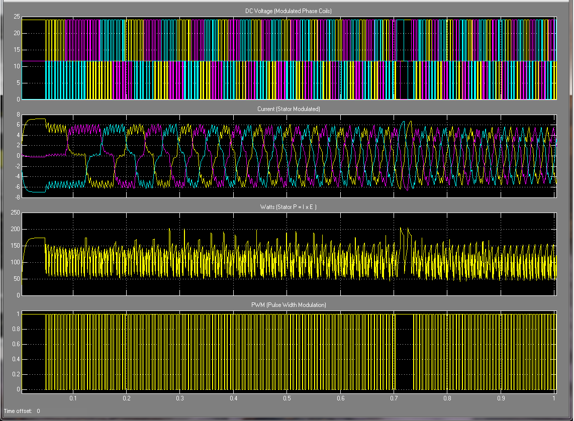

    The INA240 datasheet 7.1 AMR shows analog inputs have differential  (-80v to +80v). That seems the INA240/282 are 160V bipolar devices and not simply having an -4 to 80v CMM as the datasheet description 3 suggests.
    A TI forum engineer some time ago explained the inverter is bipolar even though it is powered from a single ended battery source. Matlab seems to concur with that engineers assessment and the PWM inverter produces a Bipolar output crossing 0 volts therefore reflects an AC battery source signal output. That is not common mode it is bipolar. In my opinion the vendor should properly test the INA devices in a bipolar inverter and show both the CMM and Bipolar maximum in this case.
    Have to wonder if the INA240/282 AMR -80v has been tested in the presence of +80v bipolar voltage swings??
    A capture of the inductive current produced in a bipolar inverter powered from a singled ended power supply.
