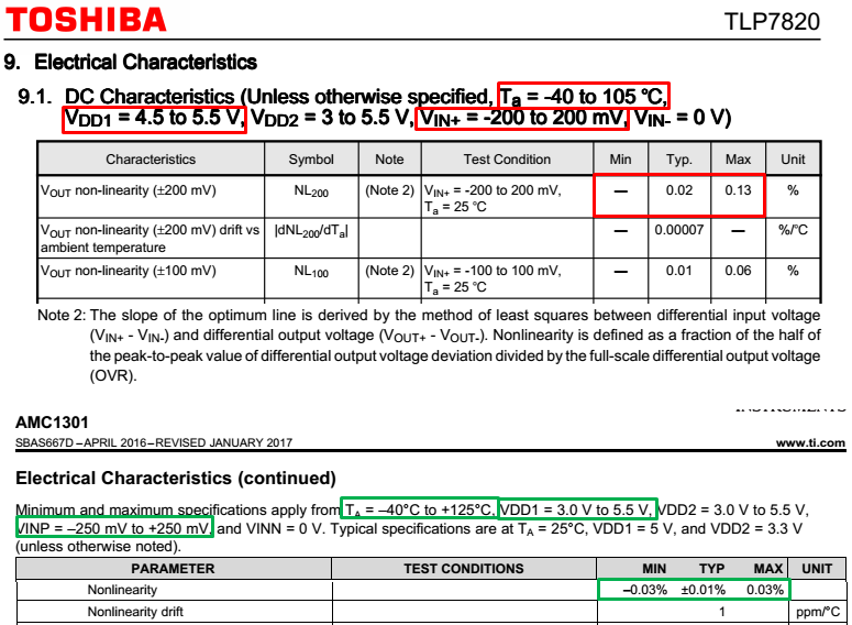

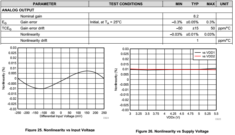

Do you have any reference documents which describe the Nonlinearity specification of AMC1301(or similar isolated amplifier)?
We have a specification and some curves in the datasheet, however it would be great help if you can share how these are tested and measured.
Thank you for your support in advance.
