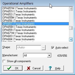

    Could you let me know where you obtained the macro-model you are using in your TINA simulation for the OPA657? It appears that you were using an incomplete model that does not accurately represent the parts performance. The OPA657 does not have enough gain bandwidth to reach 100MHz of closed loop TIA bandwidth with 10k ohms of gain. Please use the link below to access your circuit with the updated model.
    OPA657_TIA_Updated_Model

    I used the macro-model including TINA TI.
    I guess that it has the difference between on TINA TI model and model on website.
    I think the model on website is correct.

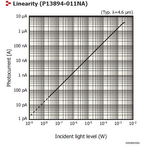

    But unfortunately it's bias current(-35uA) is much bigger than photo diode current.
    The following figure shows poto diode current.
    ttd
  • Hi tdd,
    Your application will definitely need a FET input amplifier based on the input current sensitivity requirements. Unfortunately we do not have a part available right now with FET inputs that can support the speed requirements of your application.
    My suggestion would be to use the OPA657 in a lower gain with a second stage amplifier to provide the rest of the required gain. If your signal chain eventually interfaces with a differential input ADC, then a fully differential amplifier (FDA) can be used to convert from single-ended to differential output along with adding gain.
    Jacob

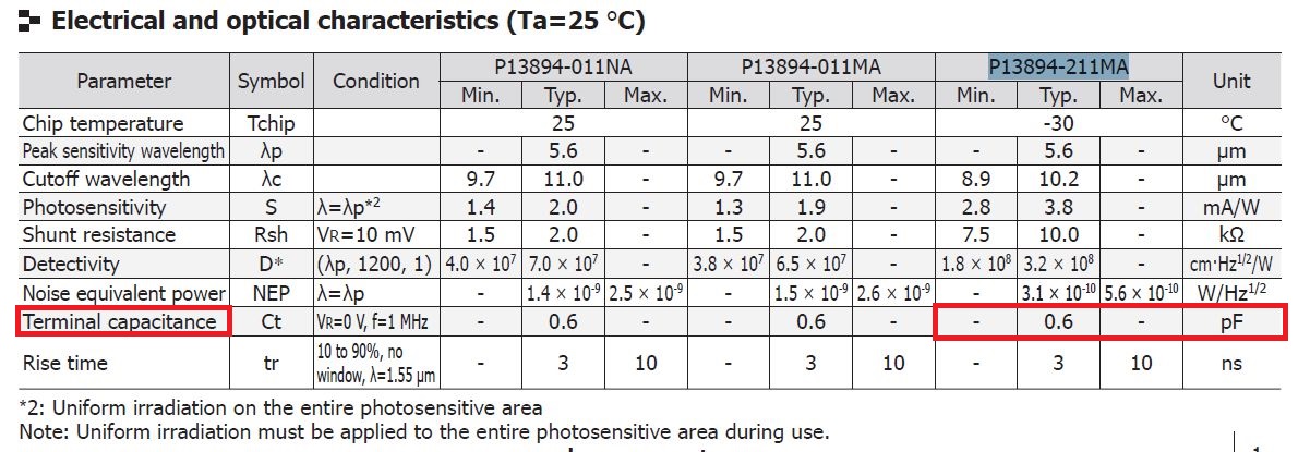

  • Hi Jacob Freet ,
    Thank you for your reply.  The diode capacitance of  P13894-211MA is 0.6pF.
    ttd
  • Hi ttd,
    My apologies, I misunderstood your reference to the datasheet example capacitor instead of the one you are using. With 0.6pF I would expect you should be able to reach 100MHz with approximately 1k Ohms of gain. This will also help to increase the feedback capacitor so that you do not need such a small value.
