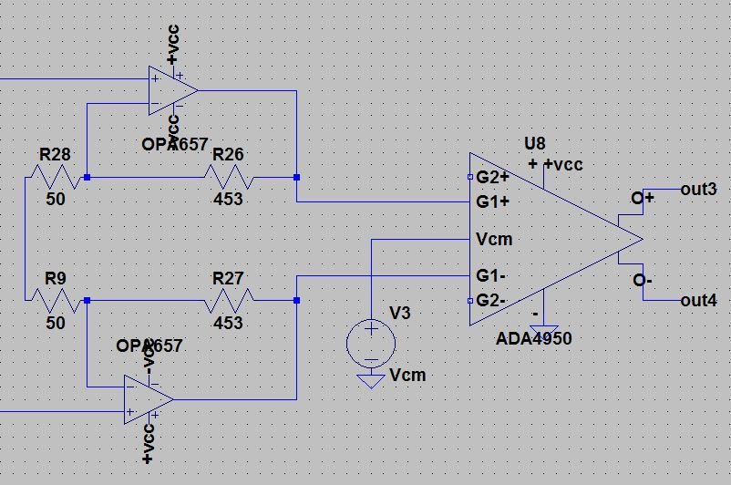

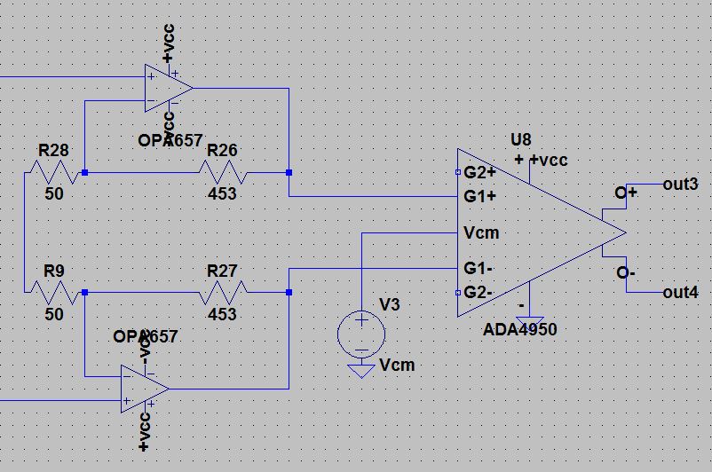

it's my circuit:

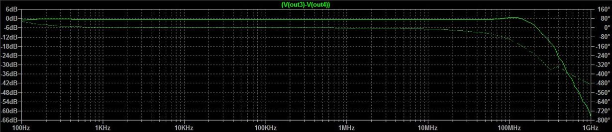

and  the frequency reponse of above amplifier is:

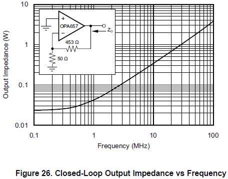

and the output impedance of the OPA657 as per its datasheet is (page 12 of OPA657's datasheet):
  • how can I make an impedance matching between OPA657 and ADA4950?

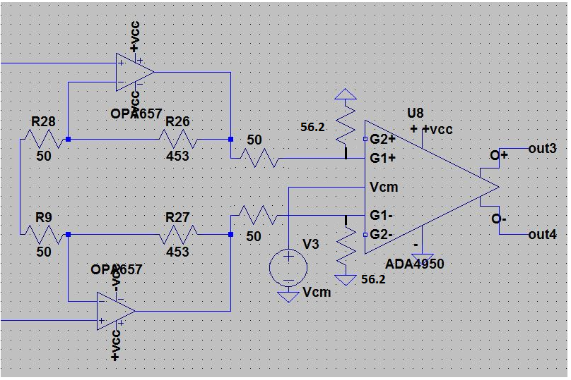

    1. It is possible to use the below circuit for 50-ohm impedance matching between the OPA657 and ADA4950.
    2. You may want to simulate this circuit in LTSpice to see if there is any problem in stability.
