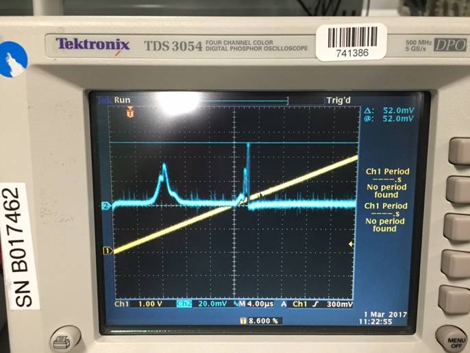

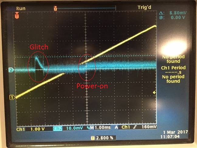

    We do not have a characterization for the timing requirement you are looking for. In testing, there is a power-on glitch that may occur and it is a function of the power supply's rate of increase. Thus, a greater rate of increase will provide a larger glitch, and vice versa. This occurs upon power-on because the internal transistors are not fully biased, and cause a violation with respect to the supply and common-mode voltages. An example shot is shown below.

    Unfortunately that is not something that I can guarantee as it is dependent on the power supply. The test data below shows the output with respect to a 50us power supply ramp rate. It stabilizes at a little over 2V and at 3.3V the output is still stabilized. My concern is if the ramp rate is too fast, then it may delay that time further and it may not be stable when it reaches 3.3V. With the test data I've shared it is fine 1us after the 3.3V point for these two tests, but again this cannot be guaranteed for every condition.
