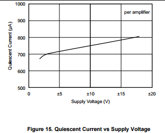

  • Prasanna,
    OPA4277 quiescent current (where Iout=0) is not a strong function of supply voltage and it is shown in the graph below.  Since you have not provided schematic, I presume that by operating current you mean quiescent current and if so on 12V single supply you could power from 500mA regulator 173 OPA4277 quads: 500/(4*.72).  If you need additional help, please provide circuit schematic showing power supplies, input voltage and component values especially in this case any resistive loading.
