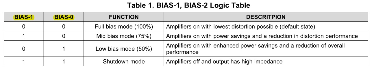

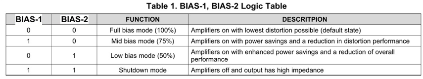

THS6214: A Typo of the datasheet
Part Number: THS6214
In table 1 of THS6214 datasheet, the BIAS pins are named as 'BIAS-1' and 'BIAS-0'. While the pin name is in fact 'BIAS-1' and 'BIAS-2'. Obviously this is a typo. How should i corresponding 'BIAS-1' 'BIAS-0' to pin name 'BIAS-1' and 'BIAS-2'? Expecting I have made the question clear.
