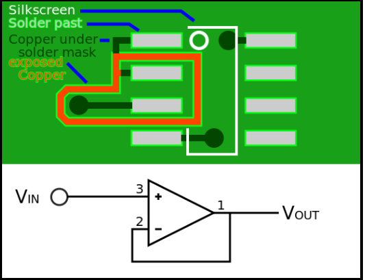

I have an unity gain buffer with OPA656(G=+1V/V) or OPA659 (G=+2V/V).
I want to reduce the leakage current to keep the input to be high impedance. so I should place a copper ring around the non-inverting trace.

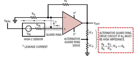

since I have a unity gain buffer at the front end of my setup How should I place a driven guard?
I found some strategies to place driven guard like below: (for unity gain buffer I couldn't find anything!) I want to build it so help me practically :)
I'm a little thinking of the second pic!
