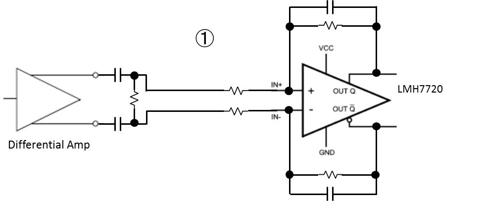

Our customer is considering the following system configurations.
1. The output of differential amp is connected to LMH7220 with using hysteresis.

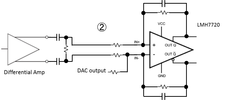

2.  DAC output is used for changing reference.
Could you please check them?

  • Hello Na Na,
    Please provide the resistor and capacitor values and expected threshold values. What is your supply voltage?
    I'm not sure that the DAC output will achieve the expected results.
    Since the input signal is AC coupled, the DC "reference" will be set by the common mode of the output (~1.2V) through the feedback resistors. Tugging on one side will distort the waveform (no longer symmetrical) and hysteresis.
    Are they trying to adjust the center point or widen the thresholds?

    I have question about the usecase of ① that I attached.
    According to the datasheet, LMH7220 is used for Fast Differential Line Receiver application.
    In this case, is the configuration of LMH7220 with use of hysteresis like ① ?
    Because the Figure 28 shows the configuration with a single output to the positive input.
    (Maybe, positive out to positive input feedback)
    From Negative Out to Negative Input configuration for use of hysteresis, acceptable?

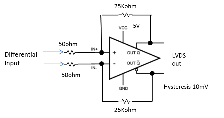

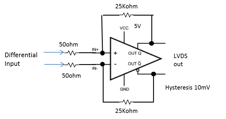

  • Hi Bahram
    Thank you for reply and I'm sorry for being ambiguous question.
    Please forget about DAC and AC coupled input.
    I attached new image.
    I didn't set capacitor and resistor value.
    I want to confirm if the configuration of hysteresis for differential inputs is correct with the connection above.
    BestRegards
  • Hello na na,
    The configuration shown in your posting is described in TI application note SNOA478A “AN-1534 Demo Board LMH7220 High Speed LVDS Comparator (Rev. A) “ at the link www.ti.com/.../technicaldocuments. The schematic is shown in Figure 1 on page 3. Section 2.1 and 2.2 describe the circuits. Section 3 provides layout consideration.
