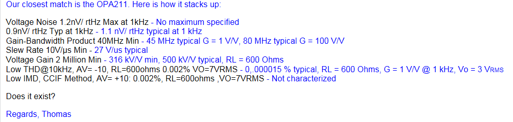

Hi Guys,
I came across another interesting DAC board that uses AK4495EQ processors.
The seller recommends single LM49860 and OPA2604 (which are duals from whatever I could find)
Looking at the recommended Op-Amps I can ONLY find duals, can I just use DUALS in the place of mono Op-Amps? will it be worse?
Are any Op-Amps you could recommend please that can be best suitable for this DAC board or better  / newer than LM49860 and OPA2604?
Many Thanks !!
