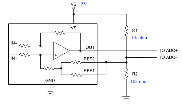

Customer evaluated INA240A1-Q1 using INA240 EVM.
Please refer evaluation circuit of attached file.
They input sine wave to IN+ and IN- and same waveform appears to ADC- with IN+.
INA240A1.pdf
Please advise if this is normal behavior of INA240.
If it is normal, please advise the reason why the same sine waveform appears to ADC-.
Best Regards.
  • Hi Toshio,
    Thank you for posting on the E2E Foruns,
    Yes, the measurements taken represent correct operation. This is due to internal bias currents as spec'd in the datasheet and the reason a differential measurement is required.
    Note however that, if the required reference is 1/2VS, REF1 can be directly tied to GND and REF2 to VS. The chip has a matched internal divider. External resistors are only required should VREF be a different value from VS/2.
  • Hello Carlos-san,
    Customer is evaluating INA240A1-Q1 with following circuit using INA240A EVM and gain seems to smaller than 20 (I could not get detail of measurement data yet.)
    I want to confirm following understanding is correct or not.
    Best Regards.
  • Hi Toshio,
    The correct equation is  V(ADC+) - V(ADC-) = (20*[(IN+)-(IN-)]).
    The gain will depend of the input/output signal. There is some attenuation at high frequencies due to the slew rate of the amplifier. I can comment further if you are able to provide some waveforms.
