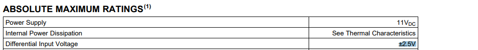

OPA2830: differential input
Part Number: OPA2830
dear Sir
I saw differential input voltage max is +/-2.5V in OPA2830
So it means if input+=4V ,Input-=1V
Input+-input-=3V ,
The opa2830 maybe damage ??
