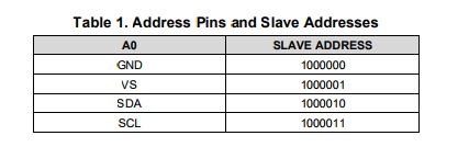

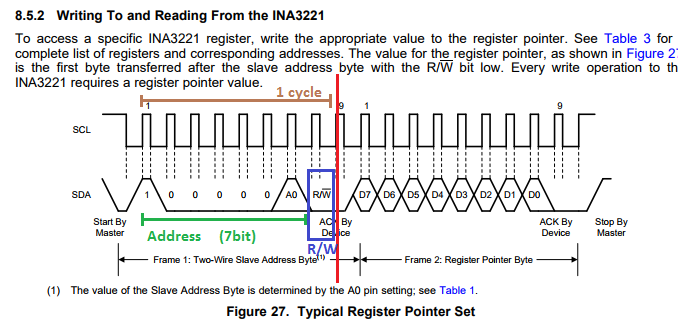

Hi all,
How many INA3221 is it possible to connect on the same I2C bus ?
Because it is possible depending on the wiring to have 4 different addresses : 0x40x, 0x41, 0x42 and 0x43.
Normally with I2C bus, the address is on 7 bits and the last one is to notify if it is for R/W correct ?
So the maximum of INA3221 on a same I2C bus is two ?
