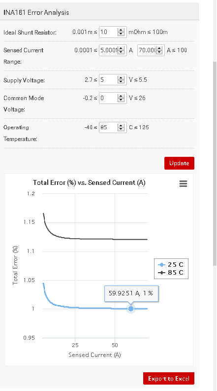

Could you help us to suggest suitable TI current monitor solution?
application condition as below
1. Measurement 5A-45A, pules current up to 75A
2. Concern resistor shunt impact power consumption
3. Can be single end and different end
4. Can be single and positive / negative power
5. Accuracy 10%~20%
  • Hi Yung,
    The INA181 seems to be a reasonable choice for your requirements. In the product page there is a tool to calculate error based on the chosen sense resistor value and expected currents, so you can play around with the values and calculate power dissipation based on your requirements.
    There are other options, if you are looking for a digital output, for example, such as the INA260 .
