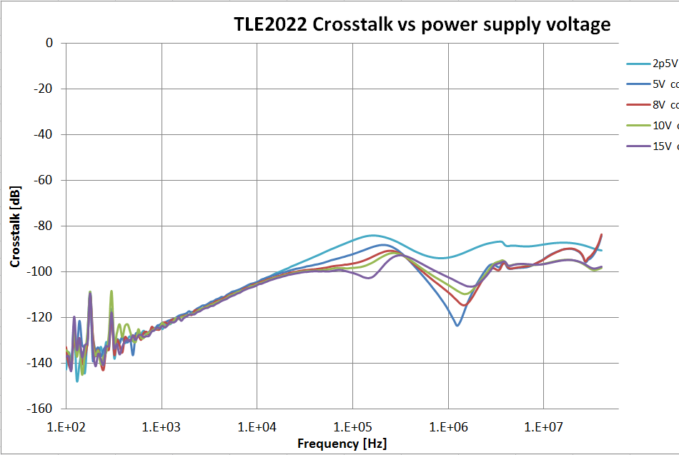

  • Hayashi-san,
    Please see the TLE2022 channel separation graph shown below. The performance will be very similar for the TLE2022-Q1. Note that the supplies are dual such as +/-15 V, etc.
