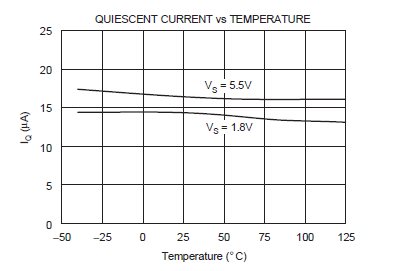

My customer asked how to estimate Iq_max at 85C and 60C.
From the datasheet (SBOS522-JUNE 2010), Iq_max(Ta 25C) = 25uA, Iq_max(overtemperature) = 30uA.
And from the graph of “QUIESCENT CURRENT vs TEMPERATURE”, Iq is reverse proportional to temperature.
Q.1) Iq_max(overtemperature) is quiescent current at -40C?
Q.2) According to “QUIESCENT CURRENT vs TEMPERATURE” graph, Iq at 25C and 60C, and 85C are almost identical value. So is it reasonable to say Iq_max at 60C and 85C is 25uA?

    And from the graph of “QUIESCENT CURRENT vs TEMPERATURE”, Iq is reverse proportional to temperature. - Note that the curve is "typical." That is usually an average of the devices that were characterized. Other devices from different production runs may have a somewhat different curvature.
    Q.1) Iq_max(overtemperature) is quiescent current at -40C?  - The Electrical Characteristics table lists the maximum Iq over the -40 C to +125 C temperature range as 30 uA. Thus, the maximum Iq limit at -40 C is 30 uA.
    Q.2) According to “QUIESCENT CURRENT vs TEMPERATURE” graph, Iq at 25C and 60C, and 85C are almost identical value. So is it reasonable to say Iq_max at 60C and 85C is 25uA? - The "typical" curves shows 25 C, 60 C and 85 C Iq levels to be very close and likely the Iq at 60 C and 85 C won't exceed 25 uA. But because there is an over-temperature Iq maximum of 30 uA it leaves the possibility open that some devices might have an Iq of 30 uA at those temperatures.
