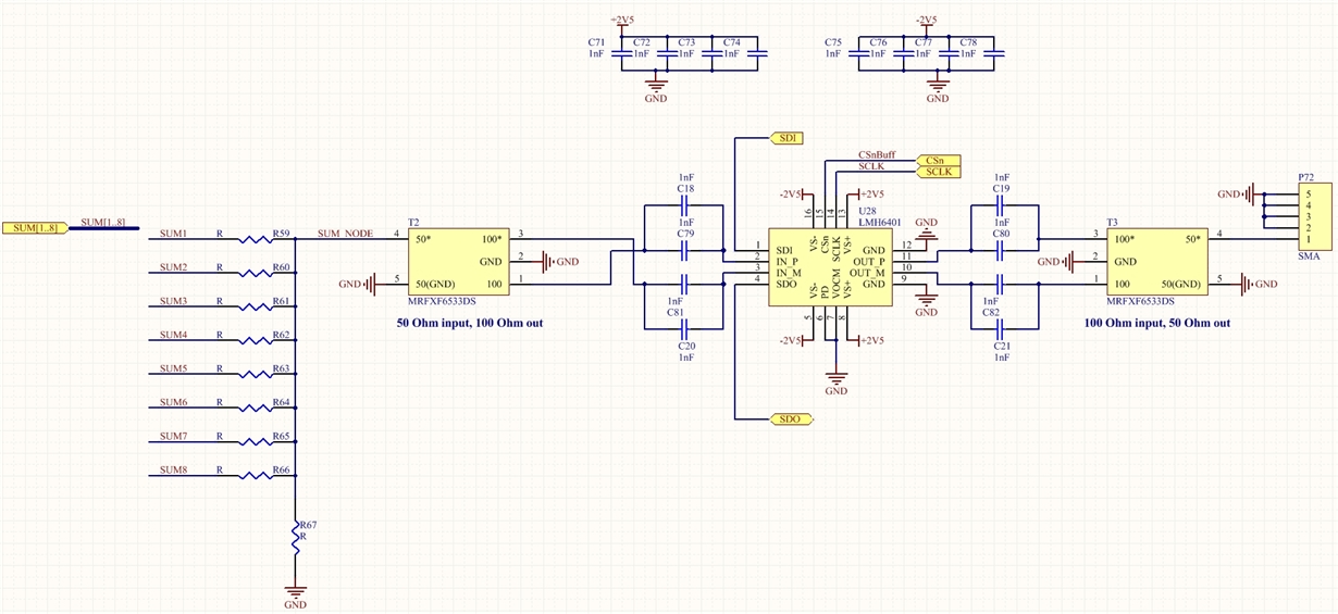

Overshoot with LMH6401 with in/out transformers, step signal input
Other Parts Discussed in Thread: LMH6401, TINA-TI

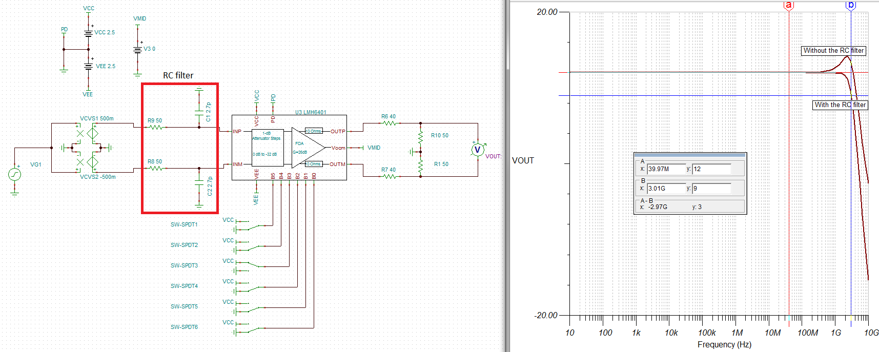

The schematic is below.

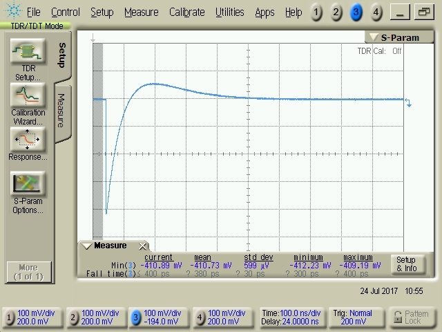

I apply a step pulse in one of SUM inputs with a TimeDomainReflectometer, step risetime is about 20 ps, and on outptut I see a big overshoot.

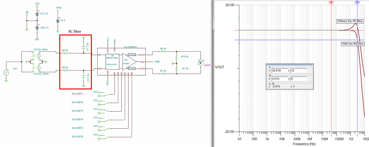

    1. A primary reason to notice overshoot in the step pulse is if there is any peaking in the frequency response of the device. The LMH6401 has ~2.5dB of peaking which could be the reason as to why you are seeing an over-shoot in the pulse response. Another reason is that you seem to have improper termination at the LMH6401 device inputs and outputs. Looking at your schematic, the LMH6401 input is 100-ohms differential whereas the input Tx- balun presents a 200-ohm source input, which could cause over-shoot due to source and load mismatch. Also, the LMH6401 outputs are directly connected to the output Tx-balun without a series output resistor. I would recommend at-least 20-ohm series resistor from each output to the Tx-balun for eliminating any sources of over-shoot. Lastly, the 20ps rise time pulse is too fast and would require a 17.5GHz amplifier to properly settle without exhibiting any overshoot. So, slowing the rise-time of the pulse would help.
    An easy method to fix the over-shoot is by incorporating an RC filter at the LMH6401 input, which should take care of the 2.5dB peaking in the frequency response as well as the input source and load mismatch. A TINA-TI circuit is attached below showing the comparison between the frequency response of with and without the input RC filter.
    LMH6401_InputRCfilter.TSC
    2. Yes, it is possible to eliminate the overshoot. The method is described in the above answer 1.

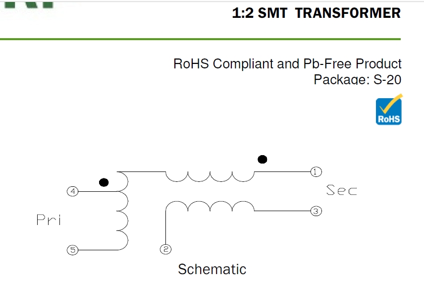

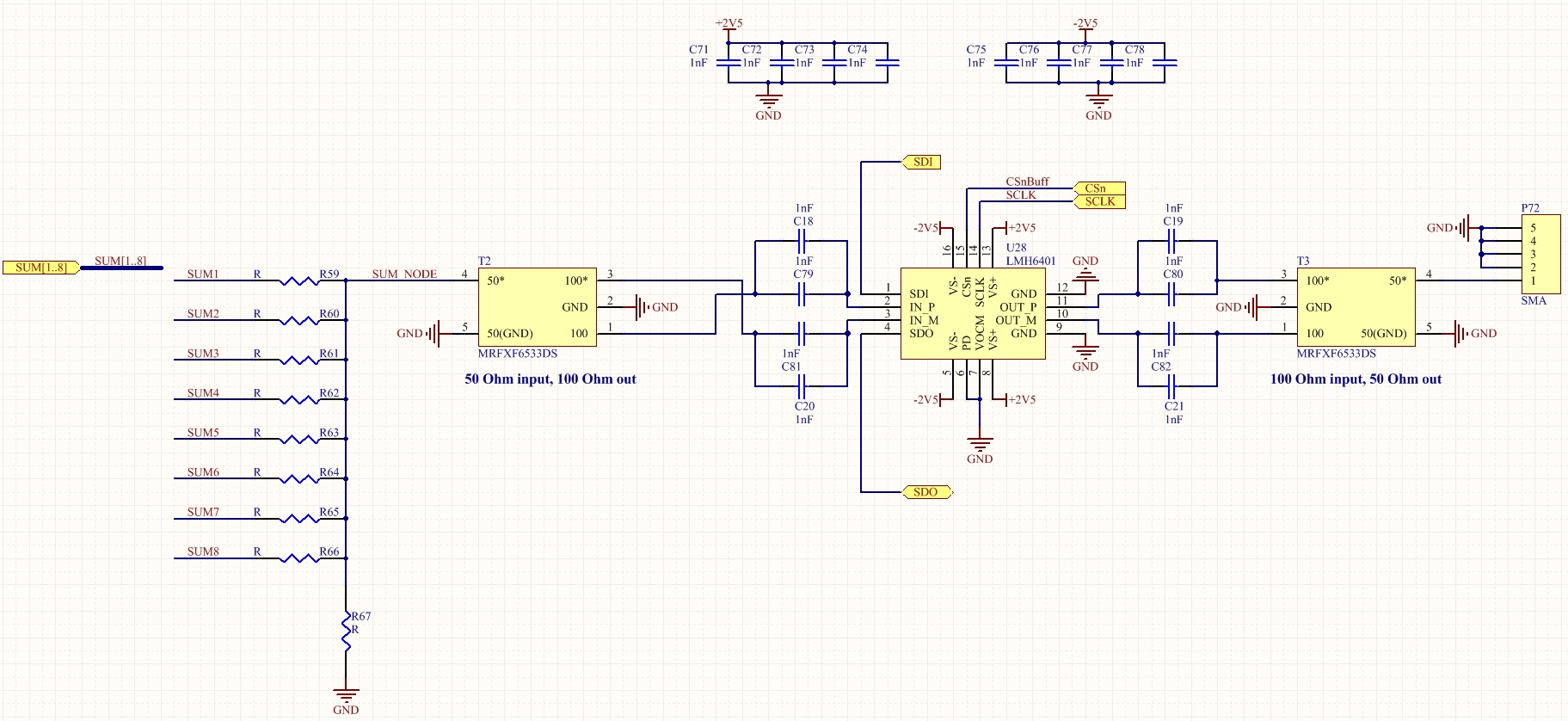

    the rf transformer windings and ratio are:
    so the impedance seen at the balanced output should be 100 Ohms if at the input there are 50 Ohms.
    In my circuit the resistive input netwrok impedance at SUM_NODE is about 10 Ohms.
    Is the input filter 50 Ohm/2.7pF the optimum or we can do some valuea adjustement to have
    the same overshoot reduction and some losses reduction?

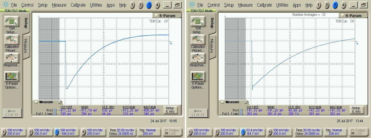

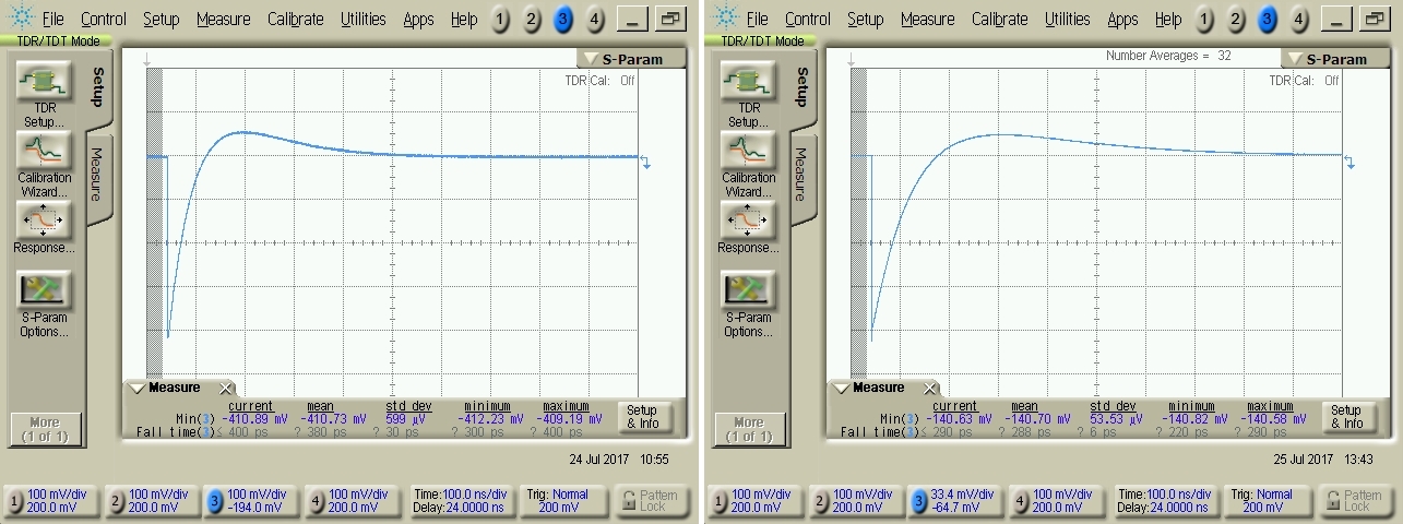

  • ... mmm ... disappeared in the displayed time window, but it has been delayed as you
    can see here, on the left before the filter and on the right after the filter implementation, only a small reduction

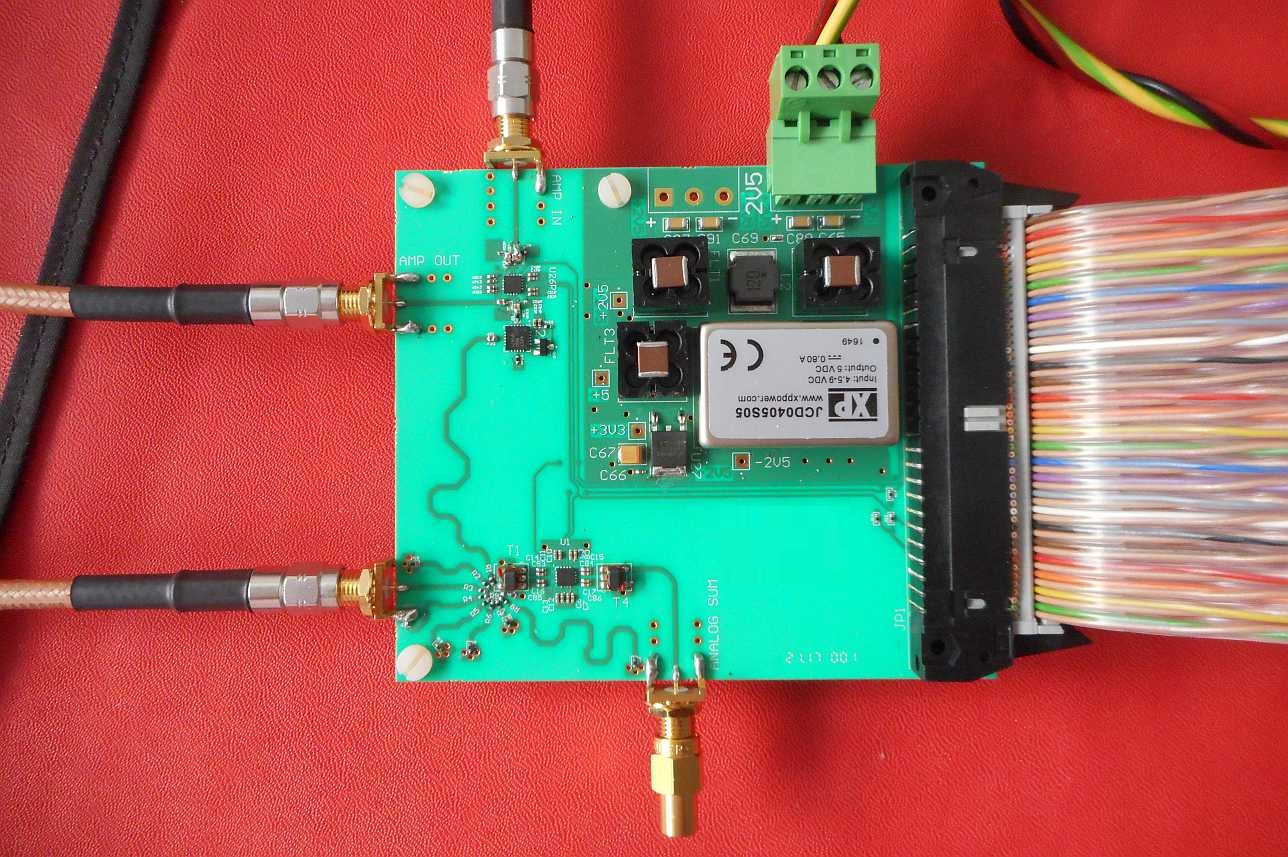

    Here a picture of the testboard, the circuit is on the bottom, you can see the two transformers.
    Input step comes from the left-bottom, output on the bottom:

    It is possible to adjust or optimize the RC input filter of 50-ohms/2.7pF in-order to get the optimum over-shoot and loss reduction. I think the right value of RC input filter will need some playing around given your setup includes the input/output transformer. If you have the S-parameter models of the input and output transformer, then I think you should be able to simulate the signal chain response in ADS and try to understand from where the over-shoot is coming from.

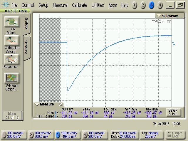

    The other thing I noticed is that the time scale on the x-axis for the zoomed out TDR capture is 100nsec/div. If the overshoot settling is that long then it probably points to the longer term settling due to thermal tail issue present in all SiGe devices built in silicon-on-insulator (SOI) technology. The thermal tail and correction is extensively documented in Section 10.1.3 of the LMH6401 datasheet. You should be able to play around with the thermal feedback control registers of the LMH6401 device in-order to try and correct the thermal tail or long-term settling. How much overshoot (in % or mV) from the nominal value (is it 410mV ?) are you recording at the LMH6401 output?
    One last thing is that I would avoid using series ac-coupling capacitors for pulse-domain measurement because it really blocks the DC content of the pulse and results in long term settling. It looks like you are operating the LMH6401 on +/-2.5V supply, so you probably don't need the 1uF cap at the input and output.

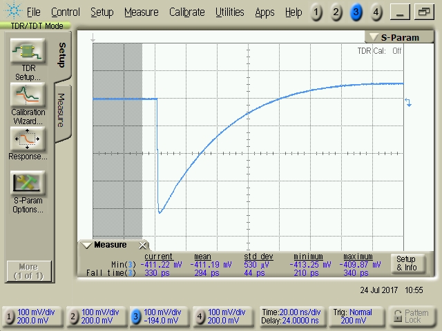

  • Hi Rohit.
    The overshoot is about 12%, 0.5 div/4.2 div.

    The overshoot problem was in the AC-coupled scheme, I have reproduced it in simulation.
    So, now I run in DC-coupling mode between all stages (my circuit has two LMH6401 stages) and the
    overshoot is disappeared.

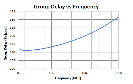

  • Hi Fabio,
    The nominal transit-time from input-to-output of LMH6401 could be ~120psec across gain settings. I have attached a plot of group delay vs frequency for maximum gain below which should give an idea about the input-to-output transit time of the LMH6401.
    Rohit
