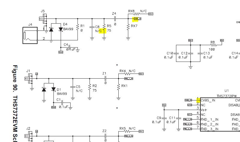

Hi Sirs,
The THS7372 datasheet specified 37.4ohm termination at CBVS input on page 1 and page 36, while it specifies 75 ohm in the EVM schematic on page 40. Would you please advise which value is better for CVBS and why?
Thank you and Best regards,
Wayne Chen

  • Hi Wayne,
    The answer to your question depends upon whether it is a current or a voltage source.
    If it is a current source like the DAC which is shown in the first image you posted - Fig 89, you probably need the 37.4 ohm resistor termination to GND. For a current-source, you always look at the Norton equivalent of the input with the source impedance (75-ohms) in parallel to the load impedance (75-ohms).
    On the contrary, the video test equipment is mainly a 75-ohm input voltage source which is why we have the 75-ohm termination to GND on the THS7327 EVM.
    Rohit
  • Hello Rohit,
    Thank you for your elaboration. May I say that we need 75ohm input termination if we use an external CVBS source or voltage mode DAC, and 37.5ohm termination if we use a current mode DAC?

  • Hi Wayne,
    Yes, that would be a correct interpretation.
