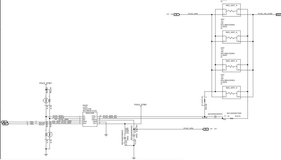

INA220: Asking for the INA220 current sensing circuit review
Part Number: INA220
Hi Team,
Could you please help review INA220 schematic?
voltage is 12V.
Imax is 140A.
SHH

  • 1) I2C Lines A0 and A1 should be connected to either valid configuration, as per table below, without resistors.
    2) The configuration with multiple shunt resistors is not recommended by TI due to the variation of voltages in different circuit locations due to PCB copper thickness and layout. Given the very low ohmic value of the current-sensing resistor, any additional high-current carrying
    impedance causes significant measurement errors - I suggest the number of shunt resistors to be minimised or reduced to one.
