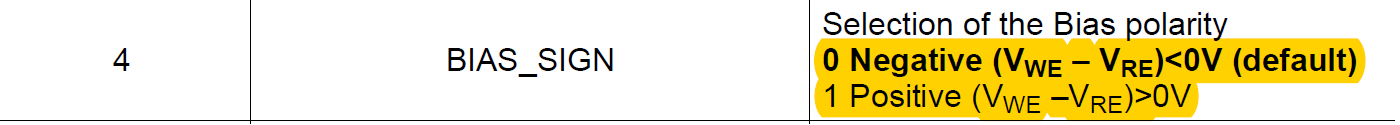

    1. May I know what's the condition I need to set BIAS_SIGN to 1?? I mean the sensor datasheet will have this information??
    There are several kind of electrochemical sensors. Some of them doesn't required any bias (polarization between RE and WE), while others may required a voltage between the RE and WE).
    The required polarization (bias) could be negative (WE > RE) or positive (RE>WE). To address any possible conditions LMP91000 has to be configured using INT_Z, BIAS_SIGN, BIAS.
    INT_Z defines the percentage of the Vref that is applied to WE
    BIAS defines the percentage of Vref that will be applied between WE and RE
    BIAS_SIGN define if the BIAS is positive or negative.
    I guess that CO-AF is a zero bias. It means that BIAS is 0%Vref and BIAS_SIGN is a don't care.
