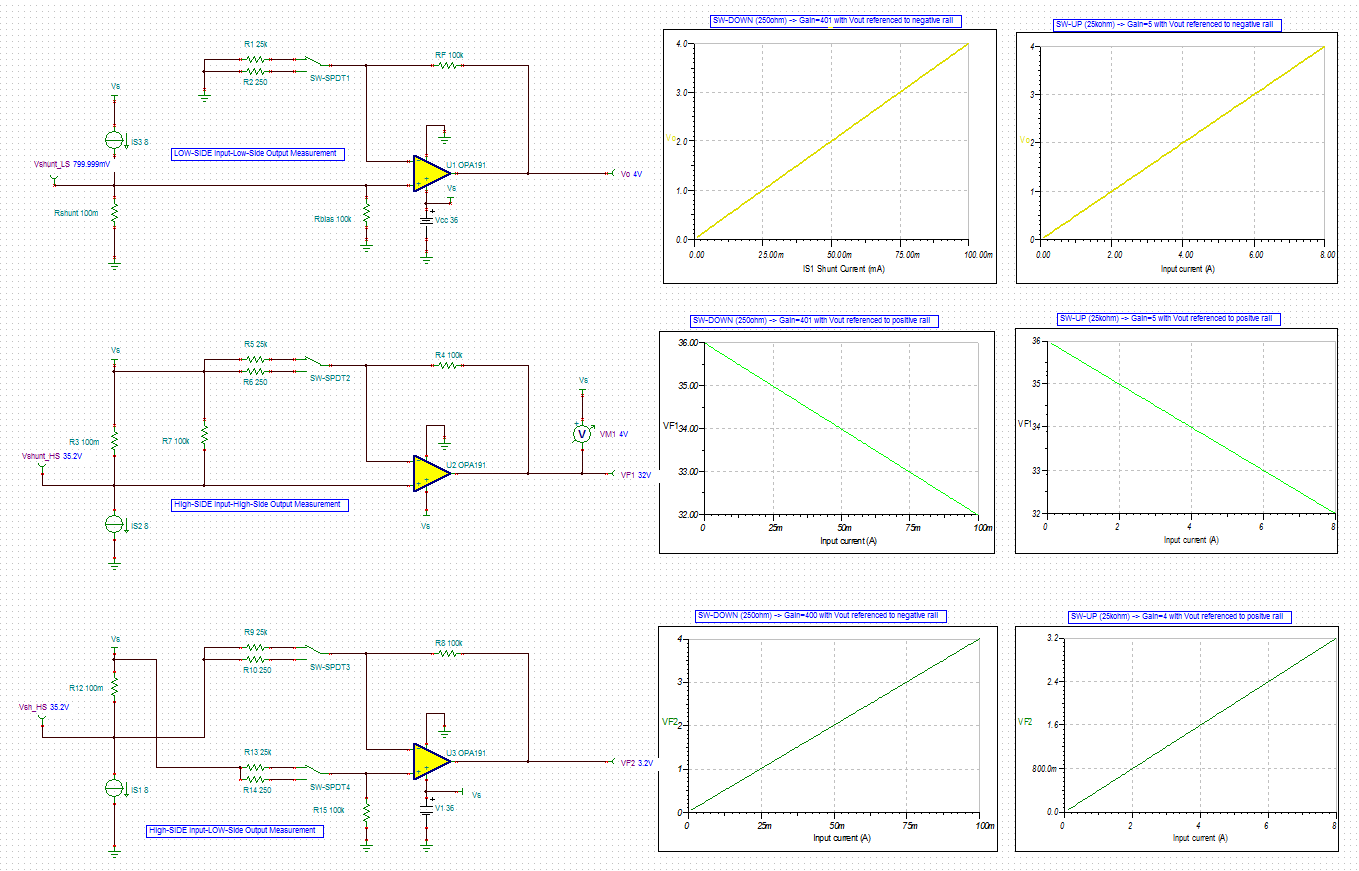

Sara,
You cannot measure high-side current with a single op amp and reference the output to a negative rail - it simply will not work.
Below please find three different methods that will work for your 1mA to 8A input current across 0.1ohm shunt resistor but this will require a change of gains at around 100mA level. For that reason, I have changed the resistor values to accomodate new gains. In order to lift the output away from the rail, the minimum gain for 1mA shunt current was set to 400 which assures the output being at least 40mV away from either rail (linear output swing).
The first circuit measure low-side current with the output referenced to negative rail. The second circuit measures high-side current with output referenced to positve rail. And the third one measures high side current with the output referenced to negative rail.
I have also attached circuit schematic so you may use for your own simulations.
Sara,
Yes, that's correct. For the circuit to work properly on 4.5V supply, you need to lower the first gain to maximum 400 (250ohm) so for 100mA shunt current, Ishunt, the output goes to 4V. The way it is now, the output would become non-linear around 4.5mA for 4.5V supply and 36mA for 36V supply - see below.
