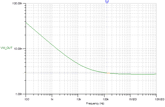

    The first thing I noticed is even with the "ideal" resistors (i.e. temperature set to -274C), the knee is far from the 1kHz whereabouts (about 20kHz in this case).

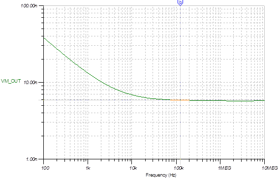

    When I take resistors into account, I get this, still way above 1kHz:

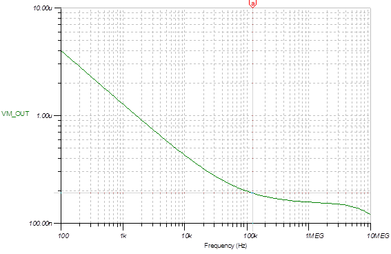

    Finally, with the values of my circuit (i.e. 5k/47k), I get this:
    Notice the knee around 100kHz. Is this right? Is there something with the model? What am I missing?

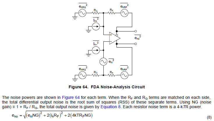

    If your system is sensitive to noise, then the only way I can think of in-order to reduce noise is by reducing the Rf. If you deduce the output noise equation below for a fully differential amplifier such as the THS4131, the input current noise (In) and 4kTR noise are not a major factor unless the Rf is increased significantly. With a higher value of Rf, the input current 1/f noise gets multiplied by Rf which looks like an increasing shift of 1/f corner to the right.
    So, the suggestion would be is to make Rf as 5k and Rg as 500 or lower in-order to meet your system noise requirement.
    Rohit
    where, Eni and In include both the 1/f and flat-band noise.

    I think the primary reason for the 1/f corner of output noise to shift towards the right is due to the increase in feedback resistor (Rf) value. The input current 1/f noise is multiplied by the Rf which changes in a log fashion from 47k to 390 ohms and thus, seems like an increasing shift of 1/f corner to the right.
    This is better understood by calculating the individual noise contributions that make up the THS4131 output noise, which I have copied from above. If we keep the noise gain (1+Rf/Rg) constant for different values of Rf, the noise contribution at the output due to the input voltage noise (eni) stays the same regardless of the Rf you choose. However, this is not the case for the current noise contribution at the output because the current noise is multiplied by the absolute value of the Rf. As a result, a logarithmic change in Rf from 47k to 390 ohms will cause this 1/f corner shift because the current 1/f noise (In_1/f) itself has a logarithmic shape to it.
    If you look at the graph above for TINA-TI simulation of output noise across various Rf and Rg, you will notice that the noise gain (1+ Rf / Rg) ~ 11 stays constant independent of Rf. This means the input voltage noise contribution at the output stays the same regardless of Rf. However, the Rf absolute value is changing as well, which will shift the output noise 1/f corner frequency due to its multiplication by the current noise 1/f (In_1/f).
    Output noise expression for a fully differential amplifier (FDA):
    where, Eni (input voltage noise)= Eni_1/f + Eni_spot and In (input current noise) = In_1/f + In_spot
    Graphical representation of 1/f shift due to Rf:

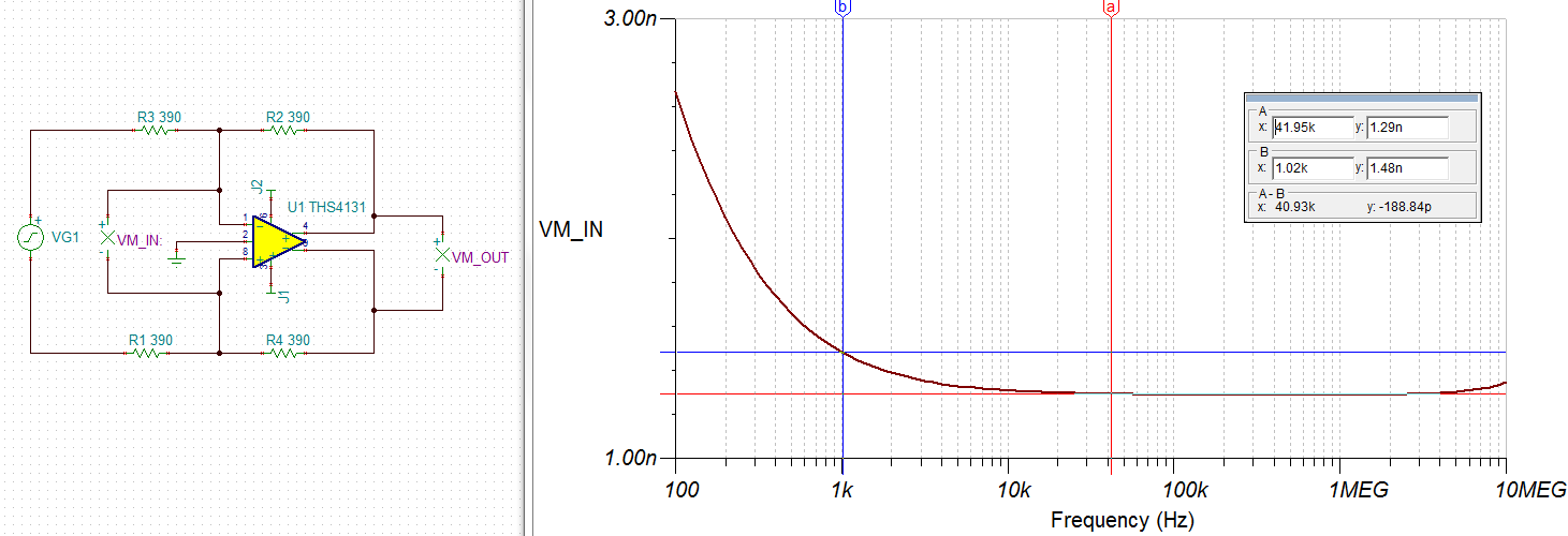

    I believe the TINA-TI simulation does match the datasheet with the nominal 390 ohms resistors for Rg and Rf. I think you should compare the input referred noise (not the output) in the TINA-TI simulation with the noise mentioned in the datasheet.
