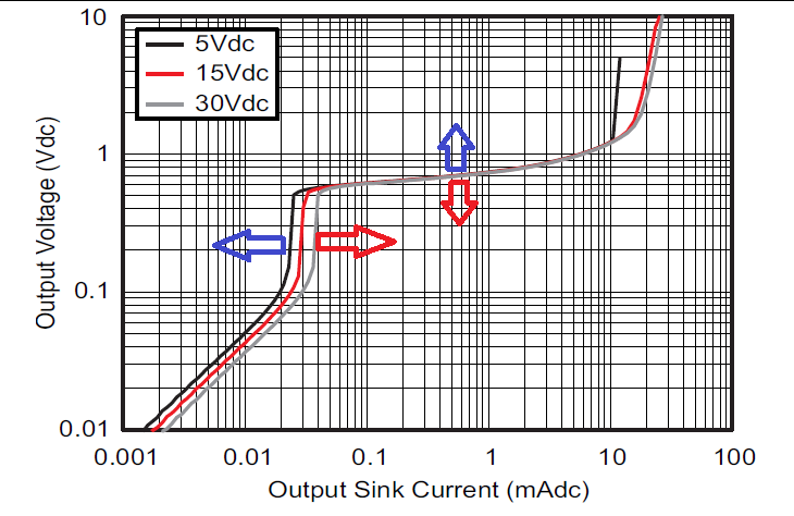

My customer use LM358 Vcc 5V supply.
Do you have VOL TEMP.char data for 5V supply ?

Hiroshi-san,
This is something I thought I had but am unable to locate.
For now, I can say that high temperature moves vertical section to the right and moves the horizontal section down.
Cold temperature has the opposite effect.
The length of the arrows in the image no not mean anything. I expect the horizontal section to move at a rate of -2mV/C
