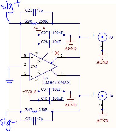

I currently have the following circuit set-up (see pic). The amplifier is overheating during operation (with no signal at output) and I've checked all pins (non-floating except pin 7, which based on the datasheet can be left floating - EN pin) including power. I also tried enabling it to high but it was still overheating. The supply is also clean (scoped). The differential input signal is a 500kHz sine, 1Vpp.
Would anyone have a rough idea what the reason is?
    The input signal should not be directly connected to the LMH6550 input pins as you have shown above. The input signal Sig+ & Sig- should be instead connected through a series resistor to the LMH6550 input pins which sets the gain of the circuit. Please refer to Figure 21 in the datasheet for typical schematic operation of the LMH6550.
    Rohit
  • Hi Rohit,
    You're correct - thank you.  I do have the  resistors in series with the signal. I clipped the picture a bit early and it didn't show up in the picture. I'm going to take a look at the drive current to the input pins, possibly might be the culprit.
    Would it be possible for you to attach a full schematic of your circuit? If the LMH6550 is being overheated, then there is a possibility that the part is oscillating. Have you tried to remove the feedback caps - C21 and C51 - to make sure the circuit stabilizes and does not get overheated?
