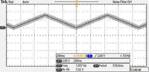

I am programming the F28PLC83 MCU to send and receive PLC signals through the analog front-end AFE031.
My goal is to send one single byte from one PLC and receive another response byte back. However, it is unclear for me how to do it.
I could already configure and convert the signal from digital to analog. The figure below shows the Tx_PGA output.
What should be my TxLine output (signal form and frequency) so my RxLine input from the other modem do the DAC conversion?

    I am happy to help you with this. Could you tell me the desired frequencies and communication standard you are trying to implement? Could you send me a schematic of your F28PLC83 MCU with the AFE031? I would like to check the hardware first before going into software.

    We are using the development kit TMDSPLCKITV4-CEN. We want to implement a feature (without a communication protocol) to determine the time of arrival (ToA) between PLC modems as simple as possible. The frequencies should be in the CENELEC range.

    The zero configuration GUI for this board is limited on sending a bit without a communication protocol. In this case the software will only send it via OFDM. The GUI allows you to customize the message which is translated into packets sent down the line. The transmit and receive will have a time stamp, however, it does not show enough precision to see the delta. The only other option with this GUI is to look at the transfer information, but again the same limitation with precision. I have attached a link to the document for operating the Zero Configuration software.
