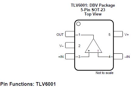

Could you tell me the difference  between TLV6001IDBVR and TLV6001RIDBVR,TLV6001UIDVR
    The different part numbers are for different pin outs of the DBV package. The TLV6001IDBVR pin out is shown in the first figure of section 6 of the TLV6001 datasheet.

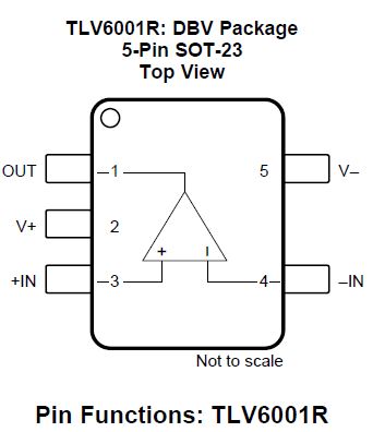

    The TLV6001RIDBVR is shown in the second figure (TLV6001R) of section 6 of the TLV6001 datasheet.

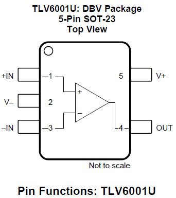

    And TLV6001UIDBVR pin out is shown in the third figure (TLV6001U) of section 6 in the TLV6001 datasheet.
