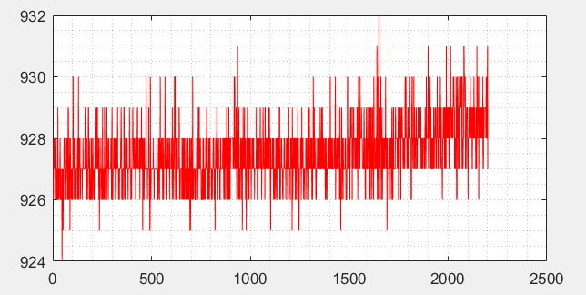

    One of the plots I got from the light-monitor data. It can be seen the line goes up slightly.

    Thank you for providing this information. I have simulated your circuit (see attached) and confirmed your configuration is stable. Is the y-axis in your attached plot supposed to be output voltage in mV? From the simulation, your RMS noise on the output is going to be about 2mVrms, which means you could expect to see roughly 12mVpp in noise on your output. With the amount of data provided it's hard to say if the output is actually drifting, but it looks like it has shifted by 1.5mV. Given the gain you are operating in, any number of things could be influencing the measurement. With the 500MOhm resistance this would translate to a shift of roughly 3pA in the photodiode. With the sensitivity of your chosen photodiode, this would correspond to an incredibly minute change in irradiance (the photodiode curves don't extend low enough to say exactly how much), so I would question if something in the setup shifted slightly to skew the measurement (light positioning relative to photodiode, intensity of ambient light entering the box, etc.)
    What kind of load are you driving with this? Additionally, it could be that the bias current or offset voltage are moving slightly with temperature because with the large gain even a slight shift in temperature could produce this amount of offset. Was this data taken after the op amp had been running for a while or immediately after startup? I think it will be very difficult to isolate the source of this error, but you may try removing the photodiode and connecting a constant current source to see if you can replicate the behavior. This will tell you if it is related to a change in the photodiode/light or a shift in the op amp parameters.
    Regarding the power supply, the output of the OPA350 cannot swing all the way to ground, so whenever there is no light shining on the photodiode, you would want to have some bias applied to the noninverting pin of the op amp to keep the output from saturating. Given that the dark current of your chosen photodiode is in the nanoamp range though, I don't think this should be an issue for you.

    To the shift, when I connect the circuit to the whole device, it can be seen right the way. Actually, the observed curved will go down gradually before a little bit swinging around a certain horizontal line.
