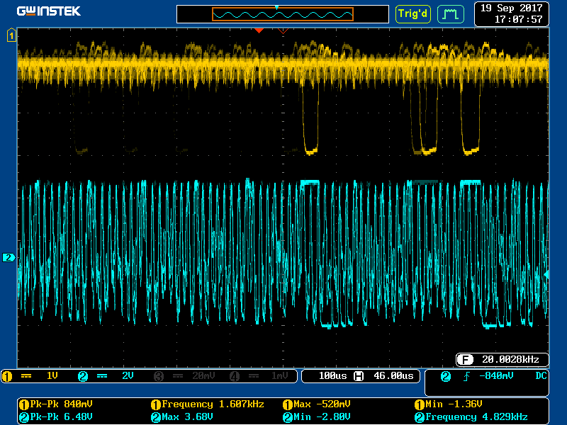

Hi there, My under graduate project is  "Visible light communication for underwater communication networks" . For that I'm using an avalanche photo diode(AD500-8) as the receiver . Here I have attached the circuit diagram of the transimpedance amplifier and the comparator. when there is a signal it works perfectly and gives a digitalized signal.. But the problem is when there is not an input signal the comparator outputs a noise signal with a peek to peek value 5v. How can I remove that noise? If want I can send the output waveforms too.Please help me in this issue.

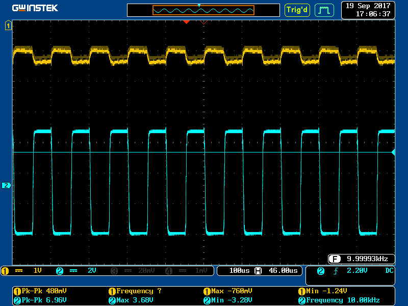

  • No signal means either no light input for the diode or absence of the diode. And the power supply is +5v and -5v. Heres the waveforms when the input signal is not there and it is there respectively.
  • Yellow color one is the output from the transimpedance amplifier and blue one is the comparator output

  • Cf is 47pF an yellow waveform is the output after the 20k pot.We check the comparator only by isollating it and it works correctly. We didnt change the bias voltage for the photo diode.

    Seems the peak-to-peak is higher (840mV, ignoring those high peaks) in yellow without light than the 480mV with light.
    Also, I noticed there seems to be a -1V DC around which the yellow trace is swinging, with and without the light; where is this -1V coming from?

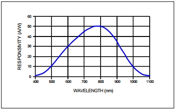

  • You mentioned before that no signal = no light or absence of diode. Does that mean you verified that the issue existed even when there was no diode.
    The APD you are using as fairly wide spectral response (~450nm to 1050nm) and I am wondering if it is picking up signal from wavelengths outside your signal spectrum or the visible spectrum (390nm to 700nm), that is causing the TIA to put out noise like output. How are you ensuring there is no light / signal to the photodiode?
    Below is the spectral response of the AD500-8 that you are using.
