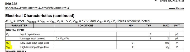

INA225: Input high and low thresholds of Gain select pins GS0 and GS1
Part Number: INA225
The datasheet says connect pin GS0 and GS1 to either VS or GND. However, the pin descriptions show they are digital input pins.
Do they have input high and low threshold voltage specs?
For example, if VS=5V, will the gain select function still work if GS0 and GS1 are connected to external 3.3V instead of VS?
