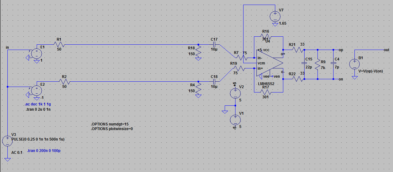

I have a deferential 50R source. I want to sample it using LMH6552 and an high speed ADC.
But there is an odd problem.
when I don't put any LPF between the sorce and the LMH6552 the step response is very good :

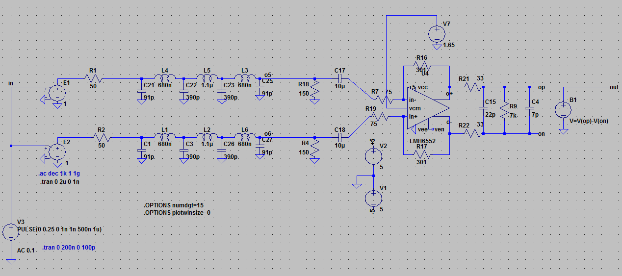

But when I put a LPF with fc=15MHz between the Source and the LMH6552, the step response is not good. I couldn't solve this issue by using some capacitors on the FDA's feedback path.
even when I buffer the source with an unity gain buffer, the problem is repeated again. I checked the signal on the 150R resistors and I found this peaking comes from here!
what should I do?
I think the response in not Butterworth! I should filter the noisy source like above.
    I think you are right that the response is not Butterworth anymore by adding the low pass filter in-between the source and the LMH6552 input. You are seeing an overshoot in the time domain pulse response probably because of that. Including a filter at the LMH6552 input causes the gain stage impedance to go low beyond the filter -3dB cut-off frequency, which effectively peaks up the amplifier roll-off slightly and not giving the Butter-worth filter response. However, if the filter were to be at the amplifier output, the relatively low output impedance of the amplifier helps in providing a stable frequency response for the filter. This is one of the reason as to why its beneficial to have the filter constructed at the amplifier output instead of the input.
    However, to fix the circuit you could try to reduce the pulse response overshoot by including a feedback cap across Rf resistors, as shown in the below image. The cap across the input pins is present for stability purposes. Also, the input filter values have been changed to get a less damped frequency response, as you can see from the lesser overshoot in the time domain pulse.

    Did you check the close loop response? 3dB cut-off frequency of the circuit is 10MHz due to putting large capacitor in the feedback of the FDA :)
    I can remove the input filter and put 5th order LPF after the FDA. but there is problem! non of the real inductors are ideal :| it's not easy to choose  inductors.
    It should be possible to re-adjust the cut-off frequency of the input filter to say 30MHz and reduce the feedback cap accordingly to give 15MHz of overall f-3dB frequency response without an overshoot. I believe this is something that you could try?

  • Hi xyz xyz,
    Improving step response and limiting broadband noise is a direct tradeoff. Think of the step response as a square wave Fourier series with a fundamental frequency of 1MHz. A 15MHz LPF will limit your Fourier series to 7 harmonics. The lower your LPF cutoff, the fewer harmonics your Fourier series will have, and the greater your overshoot. You will have to determine the appropriate balance for your application.
