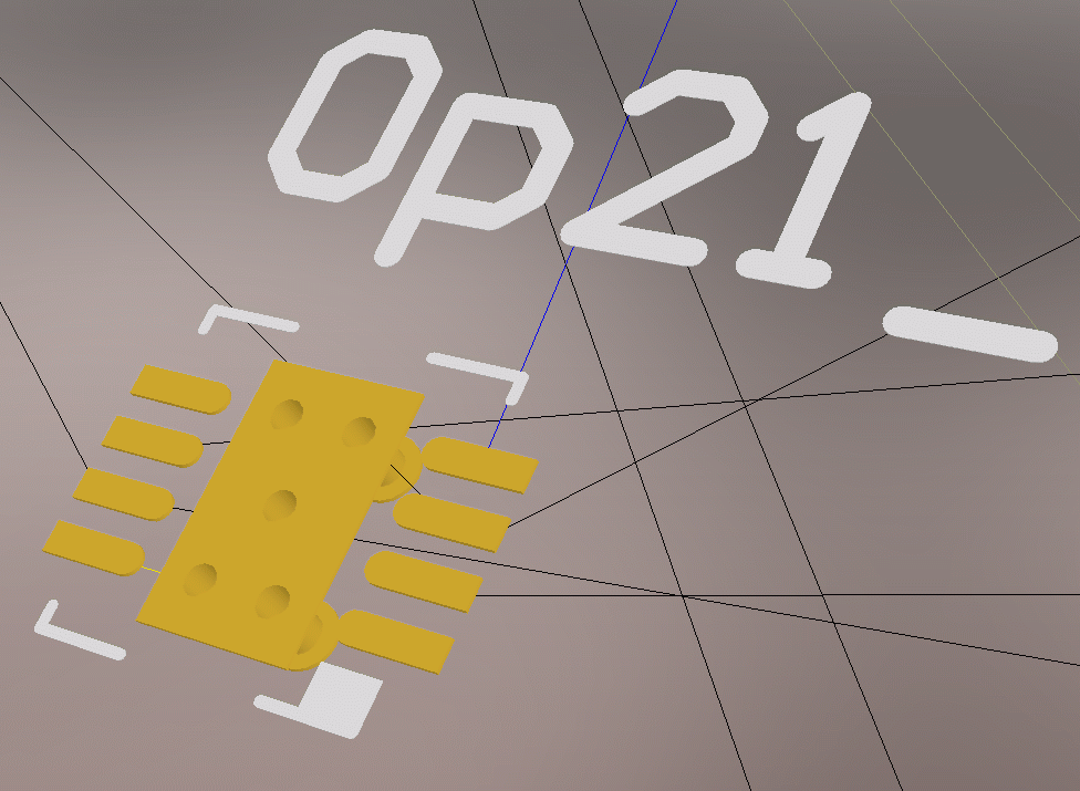

OPA211: I need the information to build the footprint and the model for Altium Designer
Part Number: OPA211
I have to revise a design from 2011. There is the SMD housinf named "DRG (S-PDSO-N8) DFN-8". I do not know if the name of the housing has changed since 2011 or if there is an error in my data base.
I have attached the old footprint.
Where can I find the new footprint and model, or at least the information how to buld it.
Thank you
Bahne

  • Dear Thomas,
    Thank you for your info. I was able to export the OPA211_DRG_8.bxl for Altium, but this project only contains two *.pas files.
    For this package, there is no *.stp and no *.pdf file available.
    Generally I have another problem with this package:
    In 2011 we ordered this device with the following description:
                    S-PDSO-N8, OPA211, Low Power Precision OpAmp in DFN8, TI, OPA211IDRGT
    I got crazy trying to find the S-PDSO-N8 package. I only found:
    Mouser - Verpackung/Gehäuse:                            WSON-8
    Im Ti Datenblatt                                                              SON(8) und DRG (S-PWSON-N8)
    At least the name of the package has changed since 2011.
    I hope you can give me some more information. when I have the dimensions and recommendations,
    I am able to build the footprint and the model by myself.
    With best regards
    Bahne

  • Dear Thomas,
    Thank you for your helpful information. As I understand, you can confirm, that in 2011 the package for the OPA211 was DRG (S-PWSON-N8)
    and now the name of the package for the same device is DRG (S-PWSON-N8).
    With this information, I can check if my footprint will match the information in "opa211.pdf" revised in June 2016.
    If this is correct, I should have all necessary information.
    Thank you very much for your help
    Bahne
