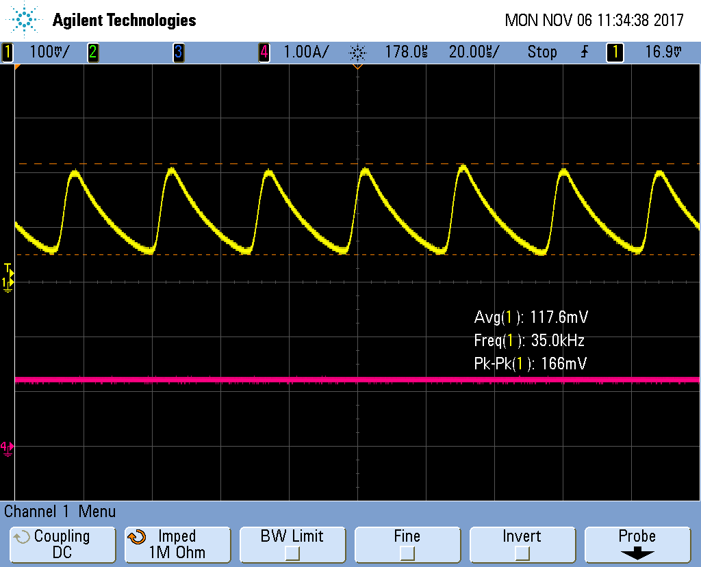

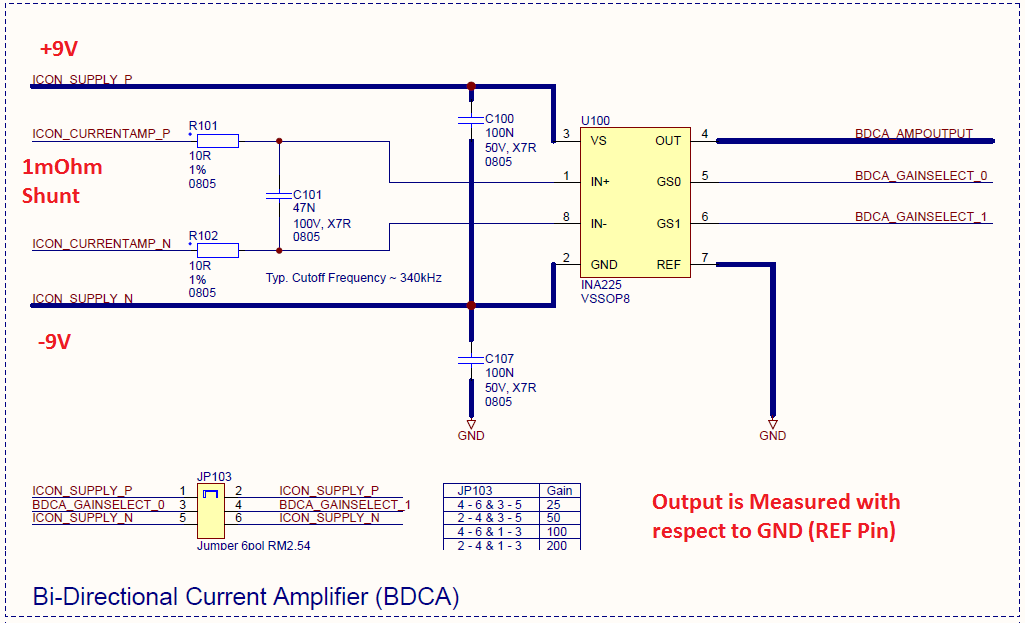

Output of the Amplifier oscillates independent of the gain and output load (resistive load).
Shunt: 1mOhm
Gain: 100
What could be the reason?
Shunt: 1mOhm
Gain: 100
Hello Peter,
The problem was found. It was the output capacitor at the connector (ESD Capacitor, Intended for ESD Protection).
For INA225-Q1, Maximum allowed output capacitor is 1nF. The Amplifier oscillates for capacitance > 1nF.
Vijay
Vijay,
For additional information on output filtering using RC circuits while maintaining stability, please see our app note Closed-Loop Analysis of Load-Induced Amplifier Stability Issues Using Zout. I hope that helps as well.
