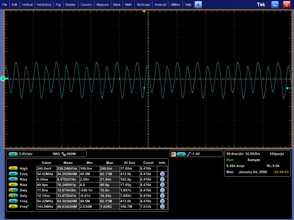

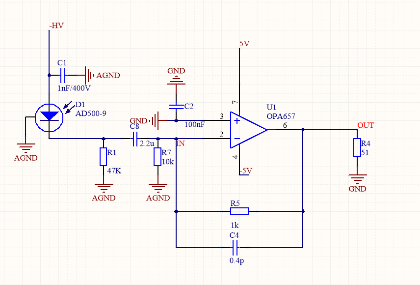

This is my schematic 。First I didn't input any signal. only gave the power,and C4 is 0.4p. the OUT output 32MHz sine wave ,amplitude is 4V.
then, I change C4 to 1p . I get this sine wave.
So how can I solved the problem?

Hi Jerry,
You should follow the design recommendations given in sections 10 & 11 of the OPA657 datasheet.
