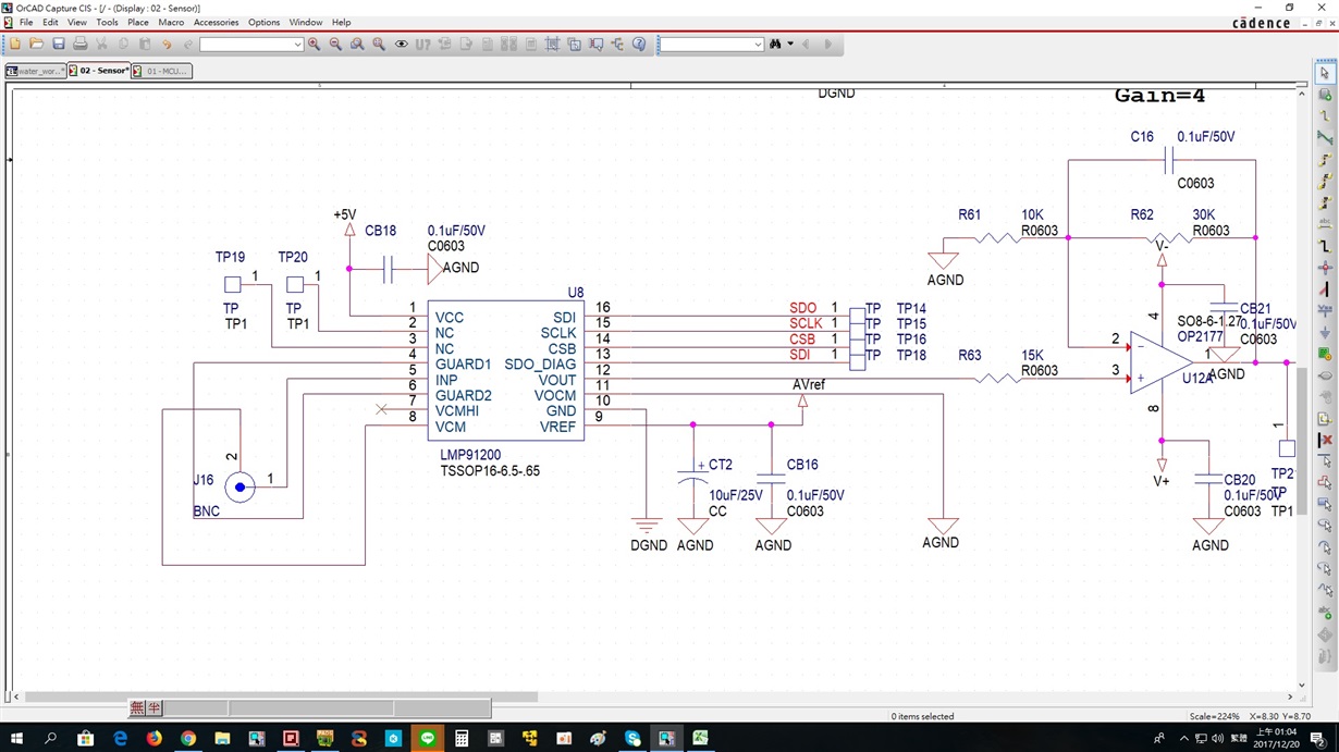

Dear Sirs,
Here are some questions from my customer. Attached is their schematics.
Please help to input your comments.
Thanks.
1. while the ph probe did not attached, the readout ph value will be 0 or 14 sometimes.
what voltage should be for Vout/Vocm while no ph probe attached?
The AVref=5V in schematics.
2. While measuring ph of water in vats, the Vout/Vocm=0V, that means ph value is 14. If customer take same water of vats and put in smaller container, the ph we get is 7.2
Is there anything wrong with it or affect by something?
Since there are old/new version of LMP91200.(difference is removed temperature sensor function), does it cause by this change?
3. Is there any recommended additional schematics for ph probe or LMP91200 to enhance signal or reduce noise?
