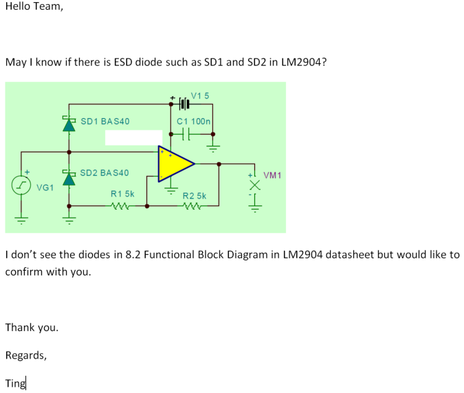

Part Number: LM2904
Ting,
There is a diode like SD2 (PN diode, not Shottky).
There is no diode like SD1. No input current flows if input is greater than VCC
