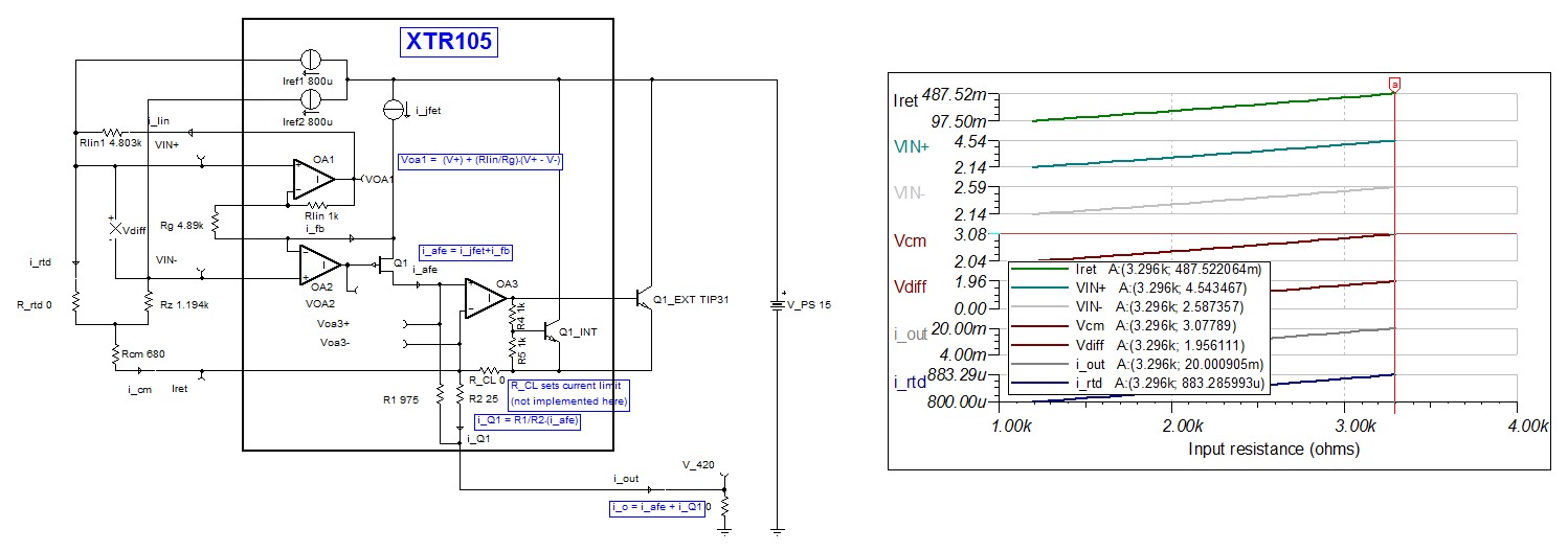

XTR105 doesn't work.
XTR105 has to deliver out 4-20 mA for a PT1000 at temperature range 50C-650C. I used a decade resistance box instead of PT1000.
1) The applied circuit is that diagram, that is recommended by the Data sheet;Texas Instruments.
2) Vin of the unit has been checked and is Vin=0-2V as datasheet promised.
3) The circuit has been tested with a RL= 0, 100, 200 Ohms at Vsupply=15V
4) The length of the transmission wire is very short , it is about 5cm.
5) XTR105 startes with 4 mA at Rz=RTD=1.194k Ohms for T_min=50C, but it goes to a saturation state at Vin about 1.3V.
6) Because of saturation the output current=Io can't reache 20mA at RTD=R2=3.296k Ohms for T_max=650C.
Maybe I did something wrong, but I share you the calculation I have done. I'm waiting for your suggestions.
