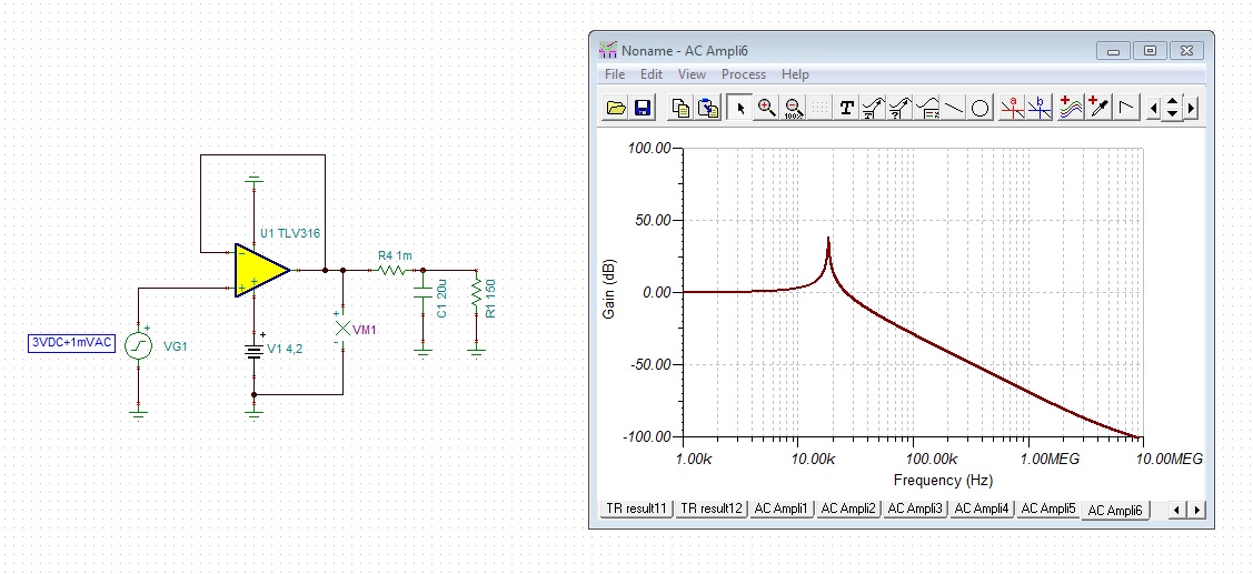

i have a question to the circuit attached. Its a simple buffer circuit with a big capacity at the output.
In simulation it looks stable with  a 1Ohm isolation resistor. I tested it on a breadboard but i havent seen a big difference with or without this resistor.
Do i need this resistor or can the ESR of the load capacity be sufficient enough?
Cliffs: Vout=3,3V
Iout up to 30mA

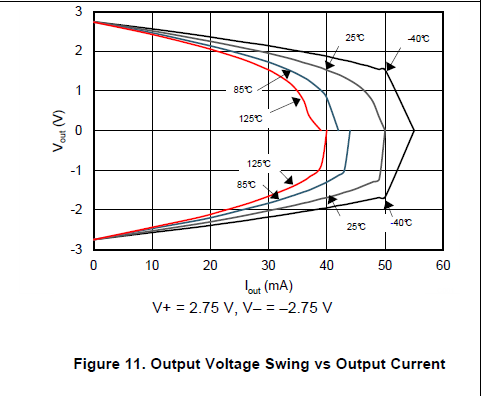

Second question, is the output current guaranteed over temperatur?
